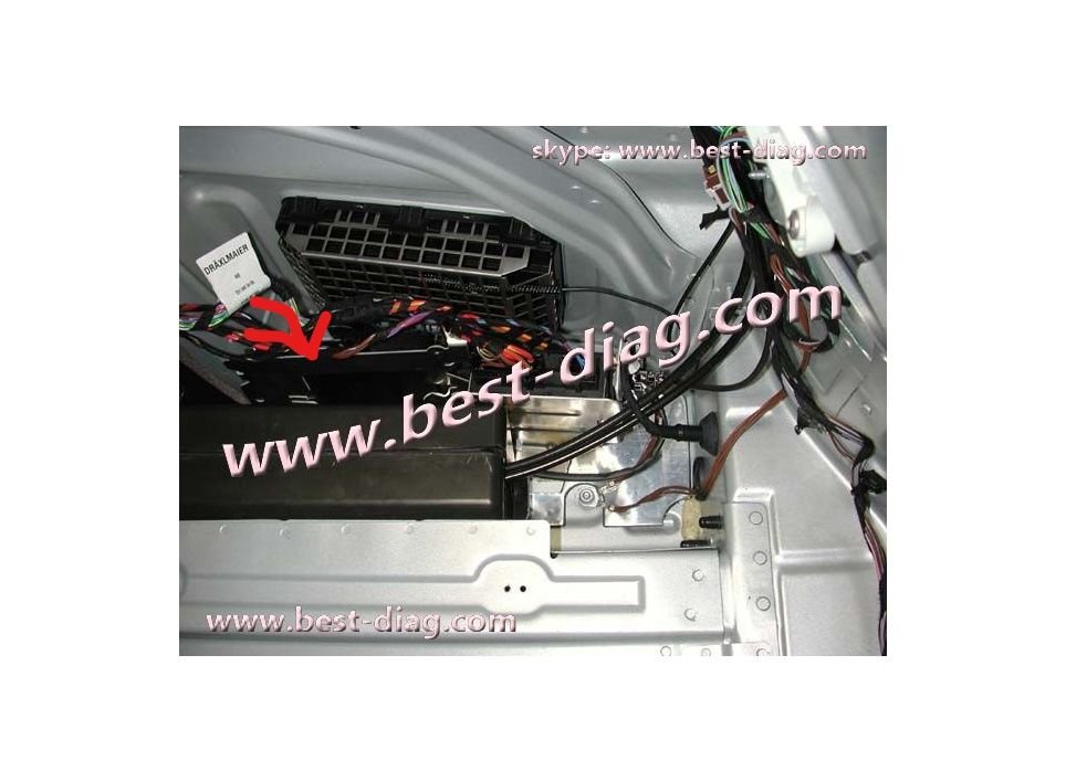

Hi guys can you please tell me where to find the n62/1 Radar c u sgr control unit is located ? 2008 S600

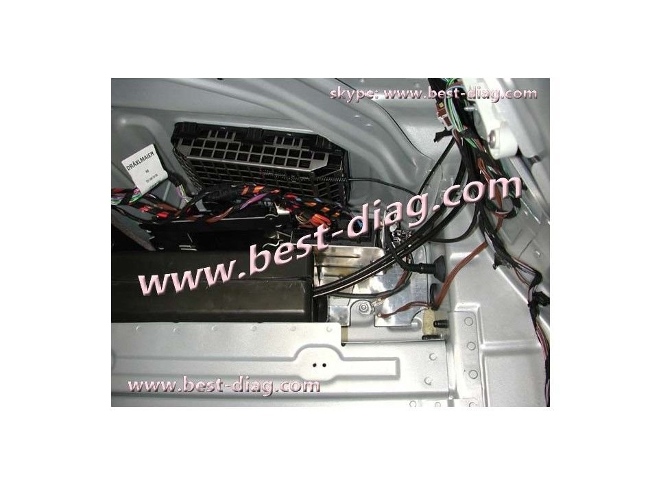

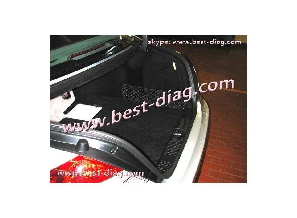

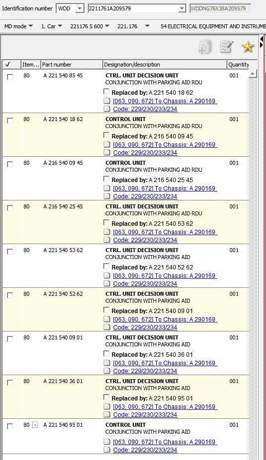

Check behind right side trunk panel. Here are compatible part #s, current being 2215409501. Actual part can be viewed here: https://www.pacificmotors.com/auto-p...21-w216-07-12/
