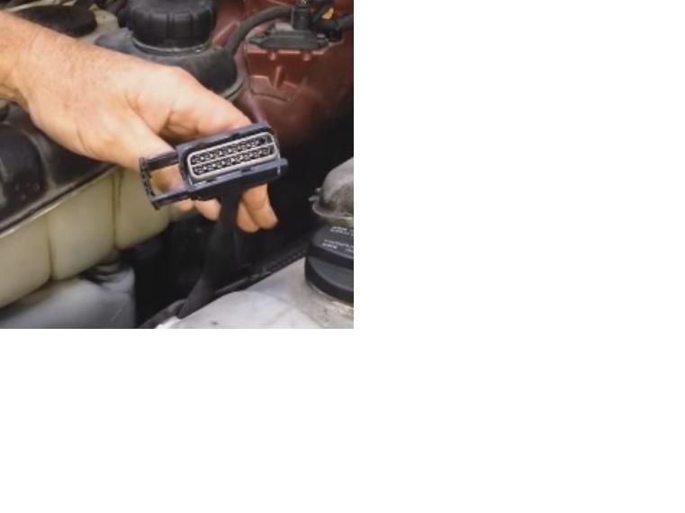

Hi Guys:
I took my 2007 S600 (with about 68K miles) on a short 100 mile round trip and, when almost home and having just filled up with gas, I got an Engine light (CEL) and noticeable loss of power. When I got home, I could smell unburned gasoline and knew something was not right. The only thing unusual about the journey was, I drove at about 75 mph in really heavy rain— probably shouldn't do that. However, that was about 2 hours before the CEL occurred.
When I got home, I let the car sit for a couple of hours and hooked up the STAR diagnostic. As suspected, P0300 and cylinders 1-6 misfires (pass side). I could still smell unburned fuel as well.
I’ve replaced my left side coil pack a couple of years ago, see, https://mbworld.org/forums/s-class-w...placement.html
So, I was guessing either right side coil pack (CP), or the voltage transformer (VT, not replaced) that sits in the middle of the engine and provides power to both right and left coil packs. Being evening, I didn't care to delve too deep into it, but decided to do one check. I removed the 18 pin (or whatever) connection to the right side coil pack and checked for ground. All okay. I snapped the connection back in and cleared the fault codes.
Voila, when started, no CEL and no unburned gas smell. I did a short test drive and had full power, no CEL and no codes...
Can it be that easy???
Or, am I looking at an intermittent problem. New fuel fill up? Heavy rain (no moisture seen anywhere)? I’ve had a Ferrari that would continually throw CEL's and cured it with a little WD-40 sprayed in connectors. I didn’t even do that here... Just unplugged and reconnected…
Unlike my last coil replacement, with random misfires, this was a whole bank of cylinders shutting down. But, it seems weird that there could be a complete shutdown followed by a full recovery???
Just wondering if anyone else has had a similar experience. A coil pack doing a few misfires is one thing. A full bank shutdown is another... You can’t drive any distance like that…
I don’t want to be worried about taking a trip of any distance and wondering if CP or VT is bad… The VT can be changed in about 15 minutes, not so the CP. And, they’re about a Grand a piece, so it’s not like my Jag XJ-8 that I carry an extra $17 CP in the trunk, just in case…
Any input or comments welcome….
Thanks…. Mark on South Padre Island

Dale, I suppose it was success. Just to follow up… I took the car on a high speed run today, with numerous short stops just to make sure the car got a full dose of heat sink. Essentially, duplicating or exceeding the conditions, as they existed, when I lost the entire right back of cylinders as described in post #1… Including, an extended run at about 2500-3000 rpm in top gear (at 3000 rpm, that’s 300 sprays of fuel and 600 sparks PER SECOND—A little V-12 trivia).
Anyway, no misfires. About 1/4 tank of premium gone but peace of mind-- sort of. To reiterate, the cure seemed to be disconnecting and reconnect the plug shown in post #1. As stated... can it really be that easy???
Regards… Mark
In my experience... yes, it can be. It's not usually, but I've seen it before.
