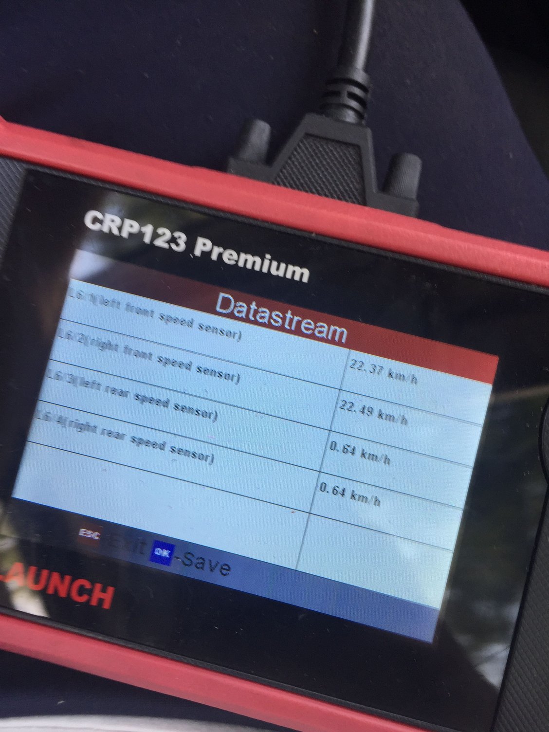

So I will start off by say a couple of weeks ago I was driving my car and I got ESP inoperative light on my cluster. I decided to check this forum to see if anyone dealt with this issue. After reading several posts I decided to order all four ABS wheel speed sensors. I first installed the front ones which were not too bad to do. I then did the back and went for a test drive. Well unfortunately not even halfway down the street did I get ABS/ESP error on my cluster and the steering wheel became very stiff to turn. I decided to connect my OBDII which can read DATASTREAM for the wheel speed sensors. It seems that the front sensors are reading correctly but the rear sensors are not reading at all. I am bit shocked as to why not. I have attached a screen shot of the OBDII . Let me know your thoughts . Also these are the sensors I bought off of ebay

I went with OEM. It cleared all codes.

On another forum last year about 5 w221 cars 2006 to 2008 era in the UK all had this message come up and one this year. Merc recco change the sensors in pairs, All those cars OK after new sensors fitted

Went OEM as well. No issues. Cleared fine.
