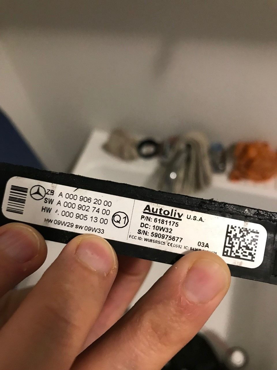

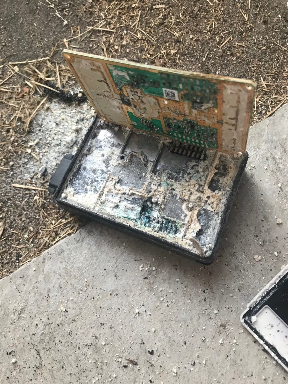

Finally took it out. I didn't have to take off the bumper but it wasn't fun, small hands would help. It was open on the edge, road salt got in and basically destroyed it.
Ebay is pretty pricey any other options?
