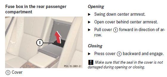

Rear SAM pull f126 (25A) for 30 minutes in an attempt to reset OCP. If this fails best to check for fault codes using MB diagnostics before replacing parts.
