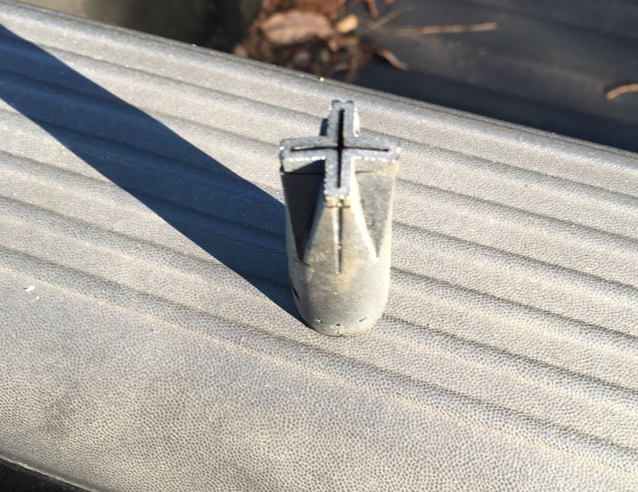

Have you cleaned drains for sunroof? there are 04 hoses go along A and C pillar and if they are clogged then water can get into cabin.
For the A pilar, you need to remove a fender above the wheel then the hose is temimated with (+) rubber reef valve at the end, it quite hard to find because it locate in side a hole and you can't take ít out, just reach it by hand and clear the dust.
try to find the hose with rubber reef valve at the end like this:
I will try that today (after the rain stops) 🤦🏽‍♀️🤦🏽‍♀️
