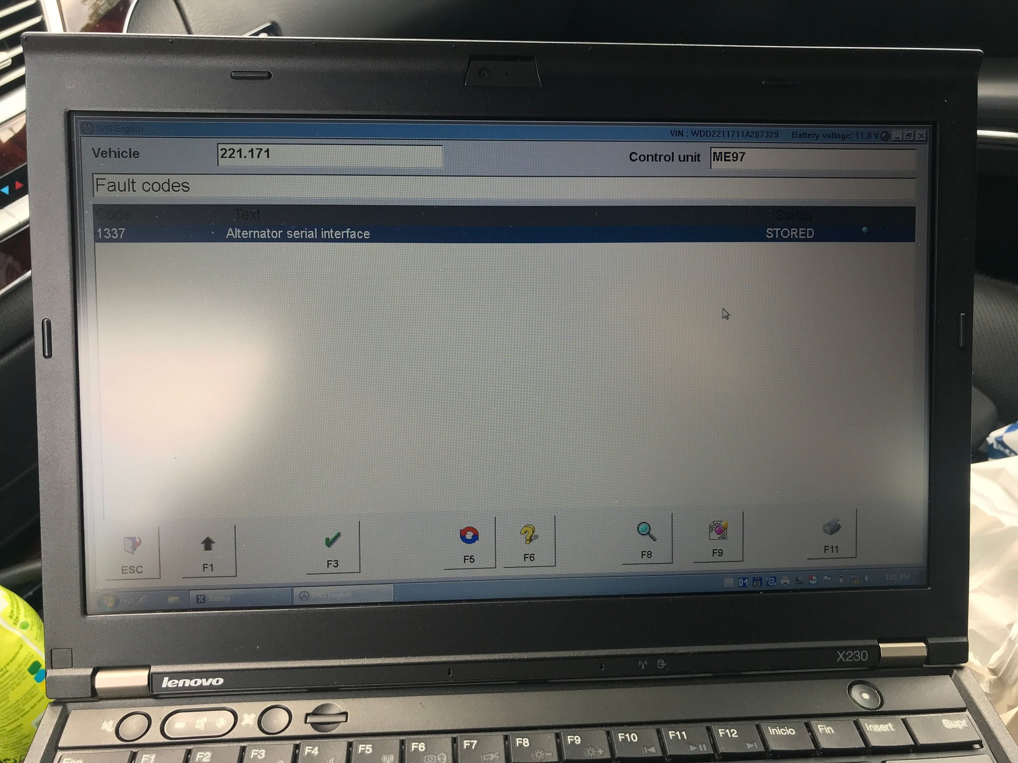

Now, I have a problem with the alternator not charging. DAS says:
CODE 1337: Alternator serial interface.

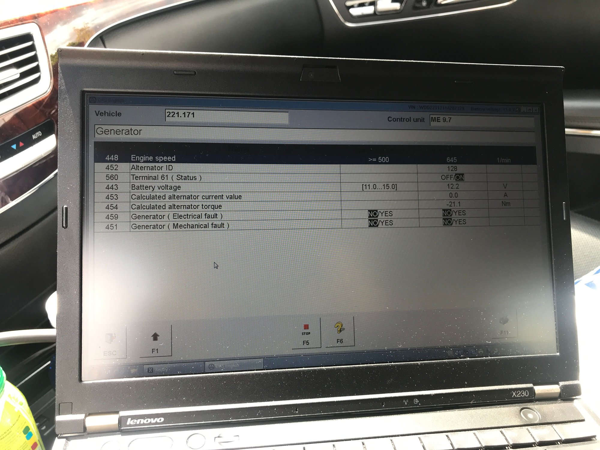

Here are the screens from Xentry. A bit strange, aren’t they?

Replace alternator regulator first, if the isue not fix then you need to replace alternator.
