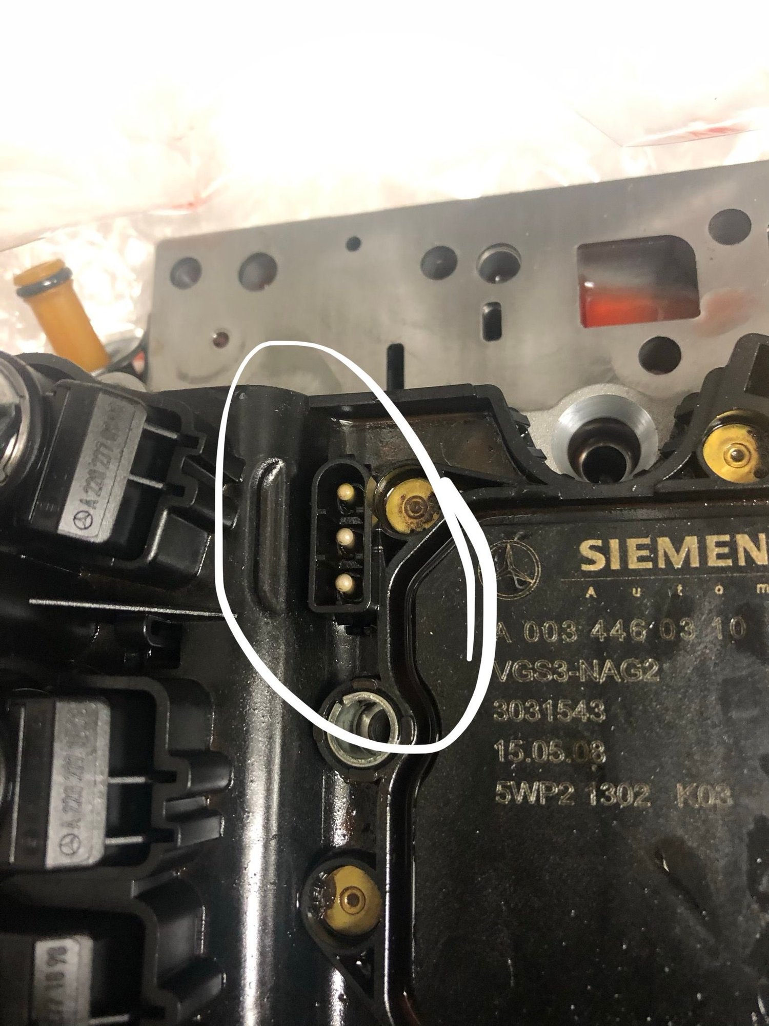

Why some have and some don’t?
Wonderful afternoon everyone, I tried researching these pins but not even google has the answer. Does anyone know what these three pins are for?
Old Aug 24, 2020 | 10:09 PM
MBENZTECH's Avatar
Joined: Feb 2007
Posts: 613
Likes: 295
From: Republic of Texas
W203 W212 W211 R53MCS
Only an experienced person can tell you.....So........That is where the solenoid for wet clutch control plugs into.
Old Aug 25, 2020 | 12:00 AM
MB CHS's Avatar
Joined: Aug 2019
Posts: 31
From: Charleston, SC
S550
Effin A I came to the right place thanks for the response. I have those three pins but don’t understand the whole wet clutch concept if you don’t mind can you explain what it does, what I’m supposed to plug in there etc.
Old Aug 25, 2020 | 08:56 AM
konigstiger's Avatar
Posts: 15,901
Likes: 4,632
From: North Scottsdale, AZ
'71 Pinto
Not experienced , see AMG SpeedShift here: https://en.wikipedia.org/wiki/Mercedes-Benz_7G-Tronic_transmission in your S550 there should be a cap at this location.
