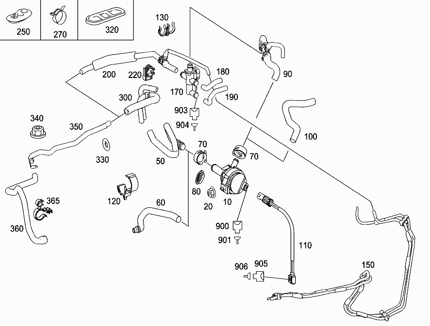

So Winter is back and I need an answer after all. I have a scan tool that checks the live data and I could see that when i raise the temperature to about 79-80 degrees the center dash vent flaps were open only 10-12% and the input coming from the control unit was also the same 10-12% so it makes me think that the center dash vents do not open up to let hot air into the cabin. Can somebody just set thier climate control to Auto and raise the temperature to 80 or so and let me know if hot air comes out of the center dash vents or not? I'd appreciate it.

there are manual vent closure / flow restriction turn knobs on each individual vent. If these are OFF nothing will come out
then we get to a question do you mean NO heat or NO airflow ? a cheap valve near the wipers wears out and stops heat working correctly, regardless of what you do in the car.
then we get to the display at the bottom of the screen....
in the middle AC you can go in here and find more confusion, like set it to control the rear (if you have it), make the rear follow the front etc. And then airflow features diffuse / focused / or whatever. The idea in AUTO with diffuse the air wafts quietly around. Focus get more air out of the vents. This setting makes the amount out of the centre vents change
If you put the fan on 7 and then go to the auto words and twiddle the comand knob you can switch air flow between three locations feet / screen / face - with a little arrow for low air flow or a big arrow for lots of airflow

Can you elaborate on what the valve is near the wipers? I've had my car a few months, and it is now getting cold. I've noticed that I have to set my heat to about 80 degrees in order for the cabin to stay decently warm. I don't recall any other car I've had needing to set the heat at anything other than a 'normal' 71 or so. Wondering if my problem is the valve you mentioned? If anyone else has input, please let me know.

its DIY ish
170 VALVE
CHANGE-OVER VALVE 001 A 23 083 000 84 - $50.90
