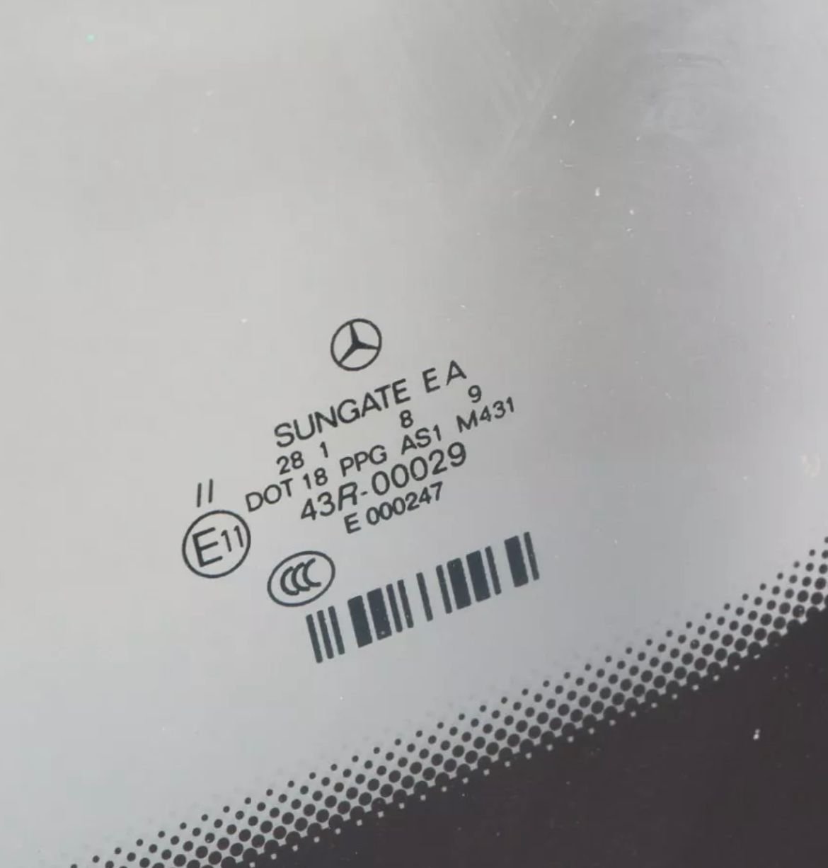

Ask safelite whether the new windshield will be from sungate. If yes then there is a chance it will be OEM.

Its a 2013 and Geico told me today that they will now reimburse me $1342 if I take to the dealer where its $3000. If I want OEM glass from Safelite, my out of pocket is $1122. Geico's glass department is saying the aftermarket glass I can get for $200 out of pocket at Safelite is the exact same windshield as the OEM likely made by the same manufacturer of the OEM, only difference is the Mercedes sticker. The dealer says thats not true so I dont know who to believe.
Yes, there are only so many glass manufacturers and aftermarket glass is often the same glass just w/o the logo. However, I've heard of cases where the optical quality is noticeably worse than OEM and also sometimes there are fitment issues leading to leaks. Insurance companies go by NAGS (National Auto Glass Specifications). If they have aftermarket glass listed for your car, then that's what the insurance covers. However, I have a strong feeling that they don't understand that you have a heated windshield, for which likely there is no NAGS replacement. My gut feeling is that Safelite will show up with aftermarket glass and then discover it is the wrong glass, because of the missing heating elements. It wouldn't be the first time. This can work in your favor, because Safelite then has the pull to get the correct glass approved. With Safelite you can make an appointment at one of their locations or you can make an appointment for a mobile installer to come to your house. You can also just go to whatever glass installer you want. In California the insurance companies can't force you to use their approved shop. If your dealer outsources the actual installation, find out who they are outsourcing it to and go directly to them and let them deal with Geico. If your dealer doesn't use an external shop, then find a good one in your area and go there. But the point is you don't have to use Safelite.
