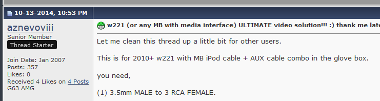

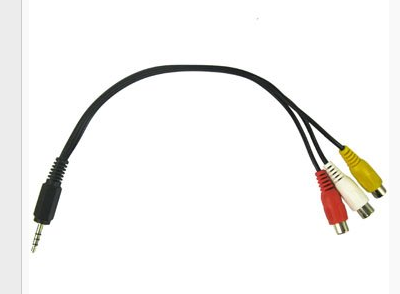

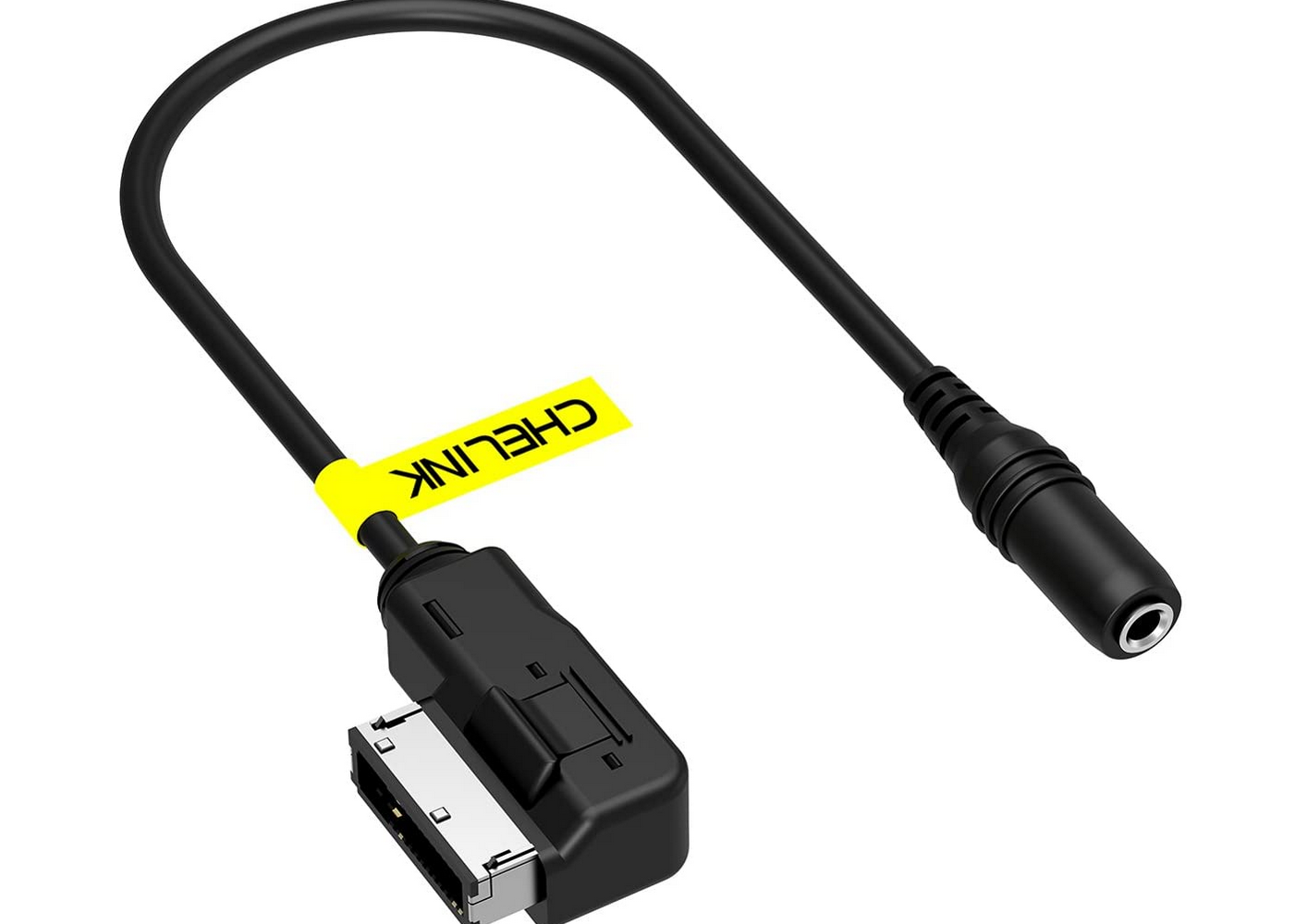

i buyed this:
this was my try, but it dont work with this:
because its only audio i buy wrong, so give a try this:
here on the forum a user had done this and wrote this:
see his thread here on mbworld
Thread
Thread
This I expect is audio on the 3.5mm phono and video VIA the 30 pin old ipod connector.... IT MIGHT work in conjunction with using a genuine Apple lighting adaptor (fakes often don't work) but if everything else is struggling who knows

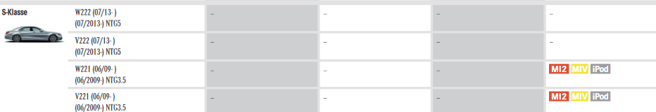

i found this great overview!!!
its from official german Mercedes Benz Site
it is written:
To connect different video sources to the media interface, please also order the media interface video cable
im searching now for this cable
