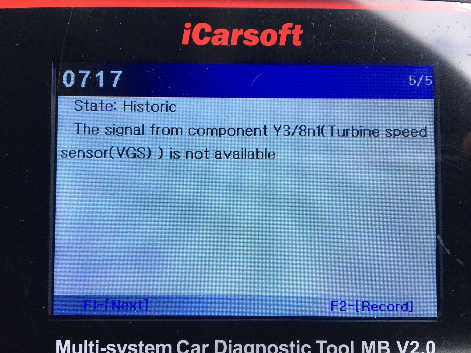

These are the error codes AFTER the conductor plate was replaced. Before that only the output shaft speed sensor was faulty.

  1. Originally I found the output speed fault with the cheap and useless iCarsoft unit you mention
  2. They (MB Nottingham) found the same fault with their super expensive Star system
  3. They recommended replacing the conductor plate and charged me £100 for the diagnoses. I asked them to be 100% sure that this was the issue and that there was nothing else wrong of any significance. They confirmed these points.
  4. They replaced the conductor plate
  5. When I got the car back I then found all three sensors in the gearbox were reading incorrectly (as shown in the cheap and useless iCarsoft device screenshots above). Also I can't select Park when the car is stationary and I couldn't select reverse.
  6. They took the car back, spent 3 weeks pissing around and now it has a Wheel speed sensor fault (all the other symptoms remain)
Now you might judge me and my iCarsoft device as useless but I have done an engine and gearbox swap on a W220. Fixed an ignition fault on a Vito that everyone said was a CAN bus issue (when it was a corroded RFI antenna) and I am an electronics engineer working in laser technology and audio amplifiers.
The iCarsoft unit cannot make up codes. Further, they corresponded to the Star system exactly.

First off, you may want to clear all error codes from the car, drive it again, and see what new ones pop up -- if you haven't done that already. If the codes weren't cleared by the dealer, you could be seeing old or very old codes along with whatever is currently wrong.
I don't see anything that would indicate issues with the wheel speed sensors... those are clearly transmission speed sensors. I've seen at least one or two of those codes on my own car, which I fixed by replacing the conductor plate. Mine would go into "limp mode" and stick in 3rd gear occasionally. If you're seeing all of those and have other transmission related problems, I'd suggest sliding under the car and checking the connector that plugs into the conductor plate. Not just checking to make sure it's plugged in and locked. If it were mine, I'd remove the plug on the outside of the transmission and make sure they actually tightened the screw (I think it's a 5 or 6 mm) in the center of the pass-thru plug. Just hand tight is fine, and you'll need a deep well socket. If they didn't tighten that, you could just have intermittent connections between the conductor plate and the rest of the car.
