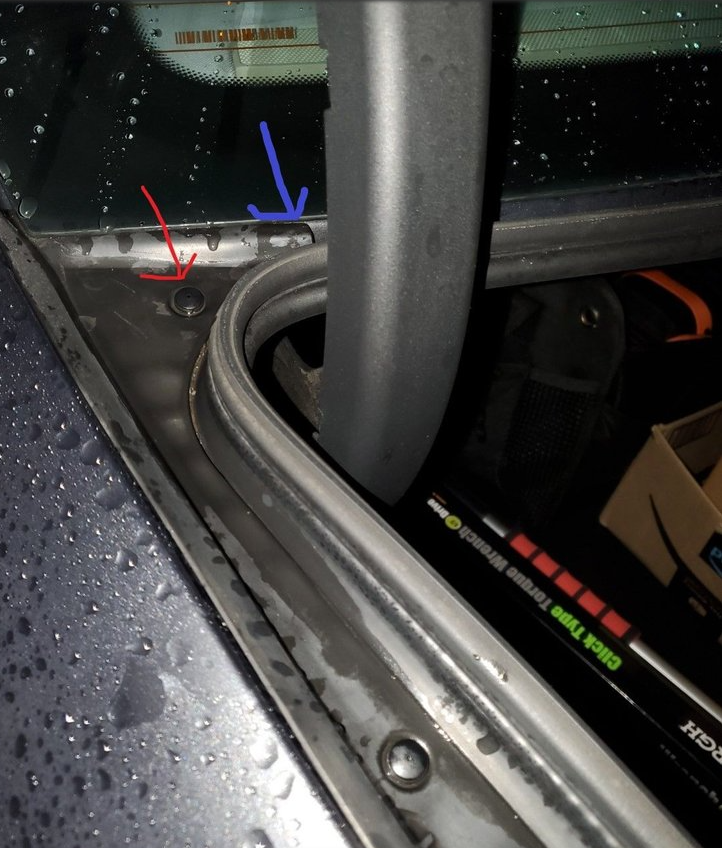

1983 Nissan Shltbox
Got this off google images. Feel free to edit with paint.

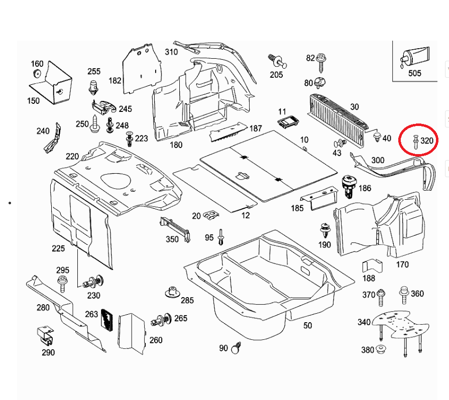

I had to replace all the fasteners holding the trim on in my W204 due to then deteriorating and crumbling apart, water would just drip right in.
Not sure how many there are in the W221 but the diagram does show the same part# for the fastener.
Fastener part# 0009915940
5 each side from memory.😉

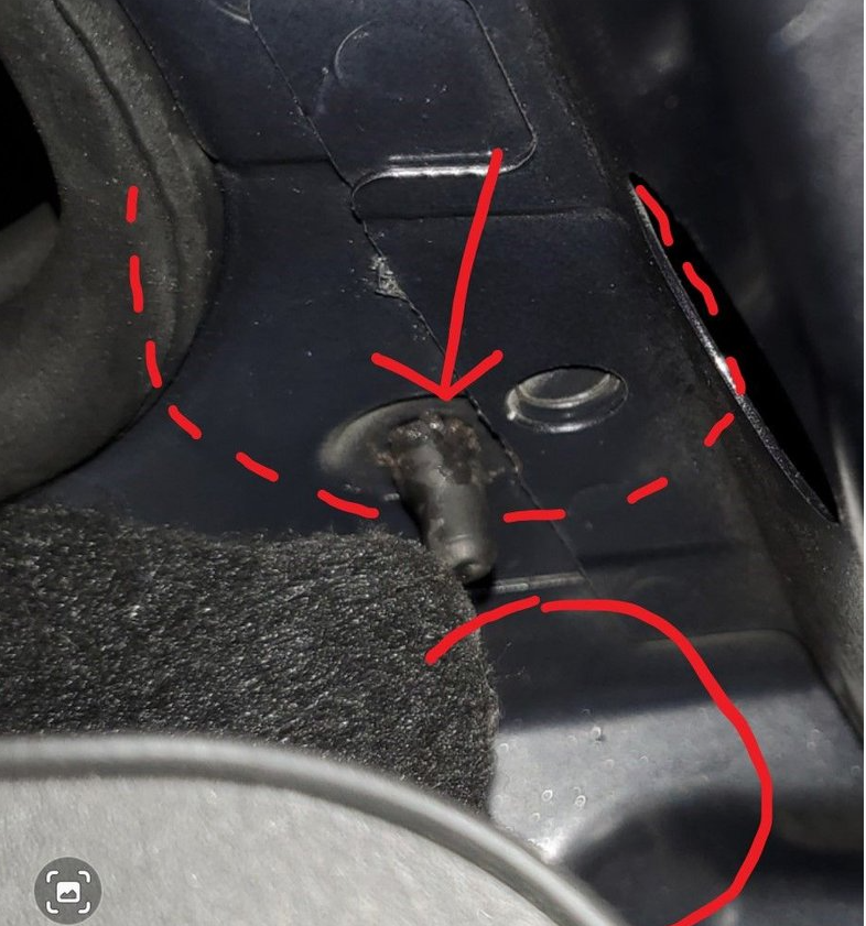

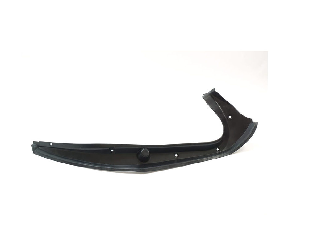

Yes it does look like 5 on each side. I looked up the left side trim part# to see what it looks like.
It does seem like a similar design with the W204. I finally found a previous thread I made with photos when I found water dripping in my W204 trunk: https://mbworld.org/forums/c-class-w...ar-window.html
Ill post some photos here to show how the water was leaking in and pooling in the trunk under the spare tire.
