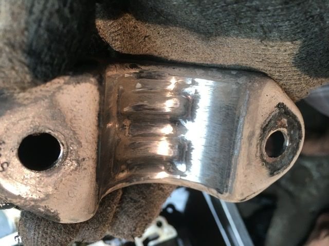

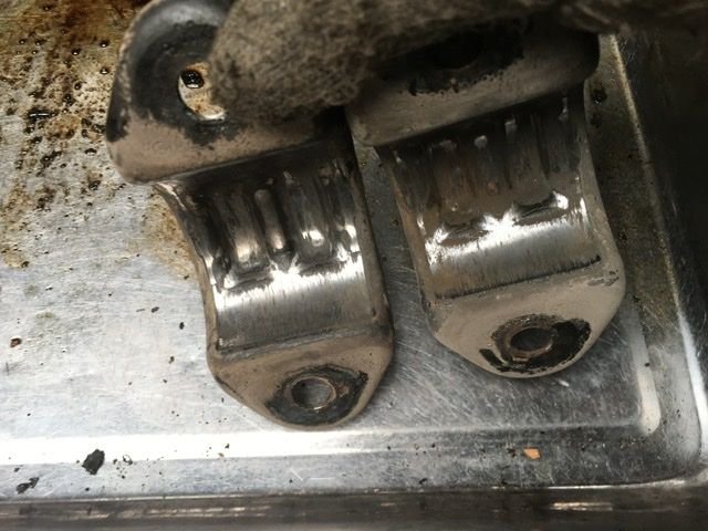

I also experienced noise come from sway bar bushing, open the sway bar mount I realized that bushings rubber is not broken but it dried over the time and make bushing smaller than normal it is then therefore it can rotate in side a mount causing a noise.
attached is photo of the mounts, it show clearly that bushing rotating in side and usually it should not. We need a special glue for properly correct, for my case glue is not available then I used a piece of rubber to reinforce the mount.

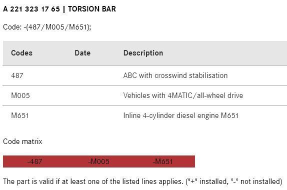

Ordered new bushings and they do not fit. I tried to use the old bushings and cut some rubber to place inside the mount as well and still no luck. The part number for the incorrect bushings of which I ordered is 2213231765. Does anyone have the correct part number and where to order in the states as I am looking to get the part asap and ordering outside the states is a bit of a pain due to the pandemic.

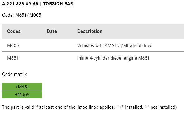

ISPUSA: 2213231765 is torsion bar part # and not compatible with 4matic. Either hunt for 2213230965 aftermarket compatible replacement bushings or replace torsion bar.
So they are just like the W220 4MATIC then where the bushings are part of the bar. Thanks Konig 👍
