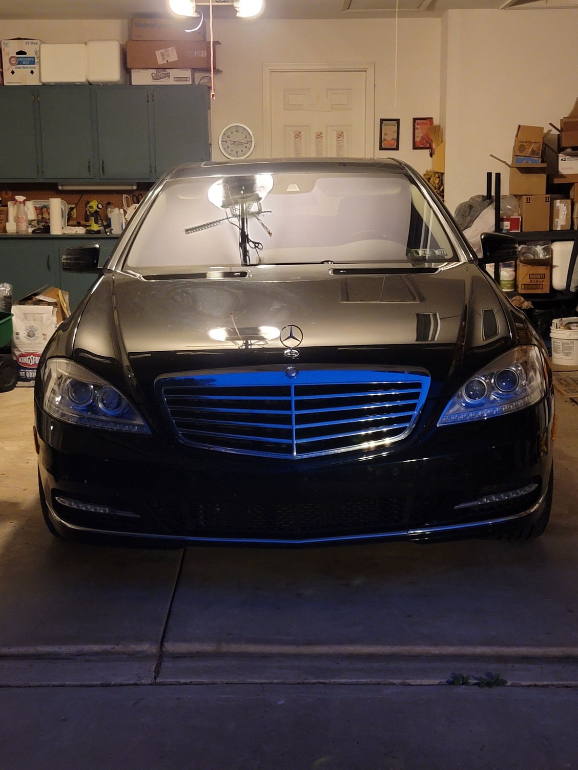

got the device tonight. In meantime local mechanic was contacted who felt that I did not have a sensor issue. He felt that I likely bent something on steering suspension and needs to on a rack and have alignment checked. said damaged wheel sensor would not pull like that. He felt maybe bent tie rod , knocked camber out, lower control arm bent, toe issue.... He recommended not driving it and having it towed to dealer. Car is leaning to one side when parked - see attached picture. When discussed more with service advisor he said I could drive it in if I wanted but no longer wanted to send someone out to pick up for me. I ran some diagnostics before updated device and got following codes : 5285: Recovery time during filling of air suspension too long, C146 No CAN data was received from control module CGW. It is rather late and will need to update diagnostic
tool later.... Deciding if I should keep Diagnostic tool or return it.

if u run Mercs keep the tool and take with you on every single drive - you'll need it most trips
if you hit anything big enough to bend an arm, I would expect you to have a damaged wheel and tyre too
and you won't normally get a warning light come on....
sitting a bit odd is common and can be lots of stuff - often goes with a seized sensor but usually an unrecognised element of the fun
it has 3 on airmatic. The single rear is very hard to get at and check.
At 50 k miles on mine the one rear totally seized, no movement at all, two fronts partially seized - they are cheap (and the front easy to do) but the breakdown when you don't a right nightmare. It could easily cost your life if going quick and 3k if try and drive it to a garage
the steering rack arm is pathetic for the size of car so it could bend...

When you start the car do you hear the airmatic pump running?
Does the car level out?
Do you hear air leaking?
You very well can have bent suspension components.
If this air shock doesn't level out it can also cause the pulling to one side.
In addition to any hard parts being damaged, I suspect something in your air suspension was damaged and is leaking.
Let us know what you find.
