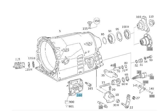

S500
the ISM often fails... this gives the message go to workshop, don't shift gears…
what it means is the mechanism to select gears has died and if you play, you might be unable to get back in to drive to get home...
it should say "don't turn off, leave in Drive, and immediately get it on a ramp at a workshop to swap out the ISM (intelligent servo module) - or you may become stranded"
yours sounds really great - you'll have to get in neutral or P to get it to crank.... and in doing so might end up stuck (but ur already stuck), if it doesn't play ball its pick up the car on low loader and if stuck in P, get it out, or disconnect prop shaft (you must never tow an auto without taking prop off !!! )

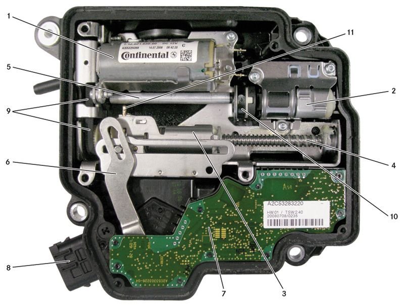

the ISM wont communicate if its dead... its a normal failure about $400, its bolts on the outside of the box, if the place doesn't know this they must never have worked on a Mercedes?
https://nemigaparts.com/cat_spares/e...asis=22117163V part 290

The ISM (intelligent servo module) is responsible for the transmission gear position it can prevent the car from starting if it does not recognize that it is in Park, mounted @ side of transmission housing.
