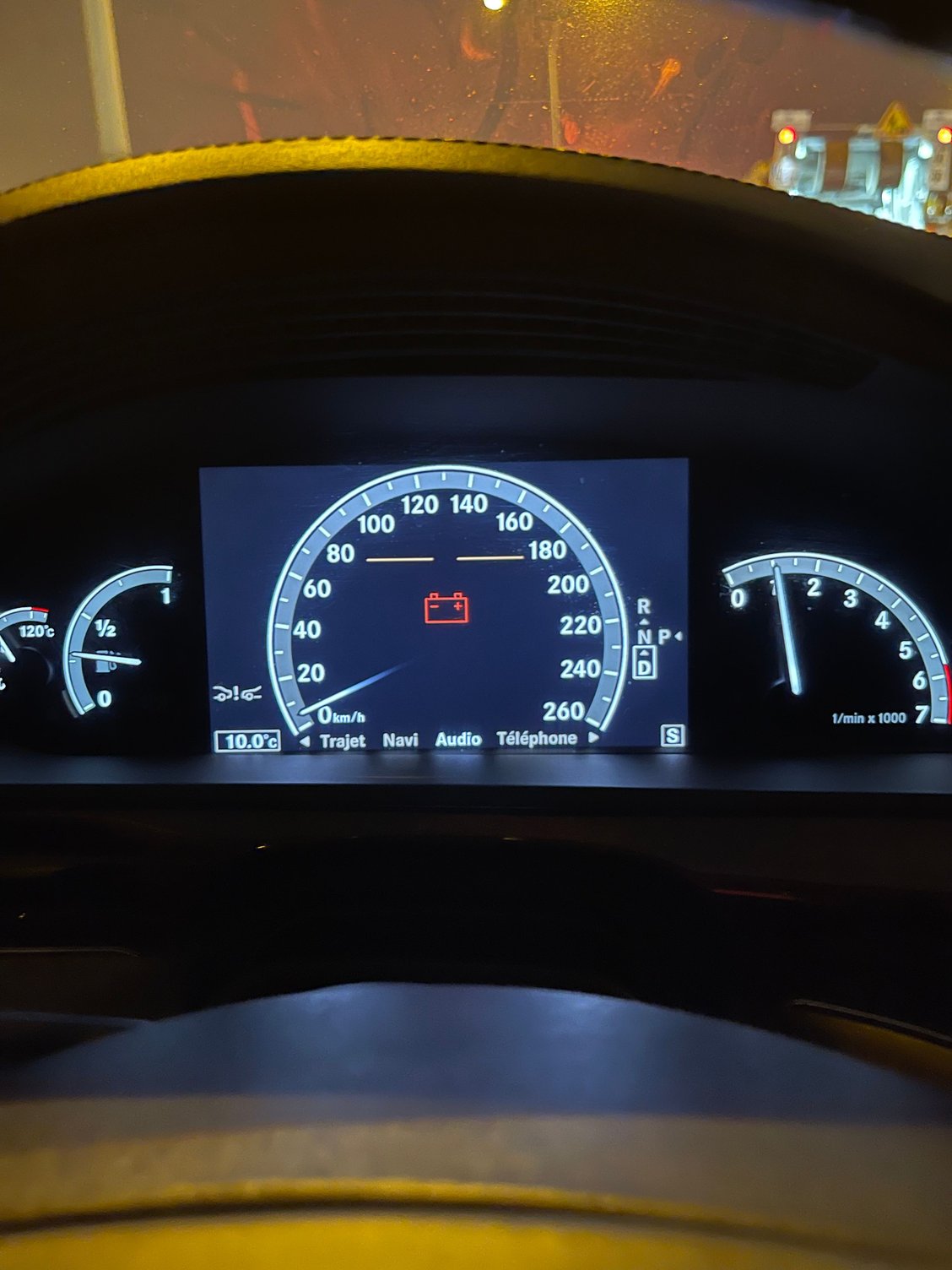

The Battery sign started to came up on my car.
At first, we believed it was the main battery that was weak. Got it replaced for an insane amount of money (they charged a lot of diagnostic )
3Km after leaving the dealership the light came back.
I went back. More diagnostic charged… and they said Alternator to be replaced…
Warning
since I don’t like to pay twice for service that is not properly given, i went to another mechanic to do the job.
we replaced to alternator since it was the official and very expensive diagnostic from the dealership.
Guess what?
We got the message again!
Then I decided to run my own little analysis. I used the “secret mode” to follow the voltage variations. Engine not running: 12.2V. Running normally 14.4V (At the very beginning it’s a bit less).
But, sometimes, I see a big drop to 12.2 and less while the engine is running. That’s the drop that generates the battery warning.
Trying to understand what was the cause of the drop, I tried a lot things (command, music, lights etc…) to realize that it was simply and only when the radiator fan was running.
I did not have time to look for mis plugged stuff or anything else causing a short circuit. I’ll show my car to the mechanic next week.
But before, did anyone had any similar experience?
What else that the fan could be involved? A captor?
Appreciate the help and will keep you posted.
