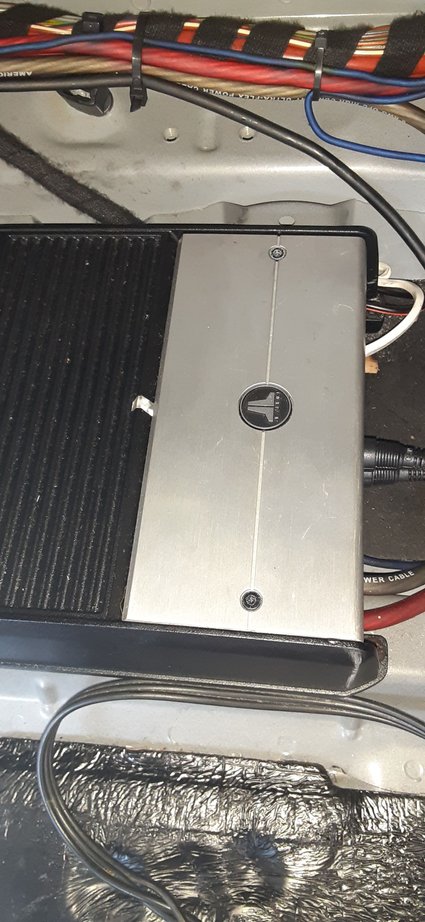

How many amplifiers supposed to be in this vehicle..? Does this amp originally come
This is installed in my vehicle. wanting to know does this come with the vehicle
in this vehicle?

S500
that's a proper amp - after-market - these are by grown ups and it puts out real quality power, not random rot
intrigued how he wired it up.... is it JUST powering a sub
Had one in my BM but for these you can get plug and play looms

Ok..just got my amp out the shop and it works good..but noticed my sub in the back isn't loud that's powered by this amp...I checked the wiring and the previous owner cut the wires from the original amp and ran it to this amp..gonna put the wires back as original to see if my sub bumps like the front does...even when I put the fader to the rear u barely hear the sub...I'm thinking maybe the rca Jack's on this amp has gone bad..but wondering if the Harmon amp would bump harder..

under the aluminium cover is all manner of tuning and vol adjutsments
this amp is 1000% better than the one merc used - more power - better sound as it can drive the unit not just waft in the breeze pretending to help the way Merc does it

So I should be able to purchase another amp in place of this job audio..a better amp..?

I think u just have a 2 channel one - is likely wiring and set up - check the model and how to set it up
https://www.jlaudio.com/collections/...mplifiers-xdv2
manual https://embed.widencdn.net/pdf/plus/...N.pdf?u=ndijqi

Omg..my woofer sounds 1000% better the original way....so the other amp has something wrong I believe it may be the Male to female plug..gonna order another plug and see how it does..if it does work..I'll just find another quality amplifier with gain control at least...

You're quick..I was trying to find that...thanks alot... here's what I have..

with a real amp driving the stock sub u will be shocked at the positive change - lets hope its working correctly - they are good quality amps used by lots - yes there are bigger better ones - but bang for your buck, we are talking good higher end hifi, not budget rot
middle of the amp, between the aluminium and the black face a small LED
2) Constant Green: The amplifier is on and functioning normally, audio output is active.
