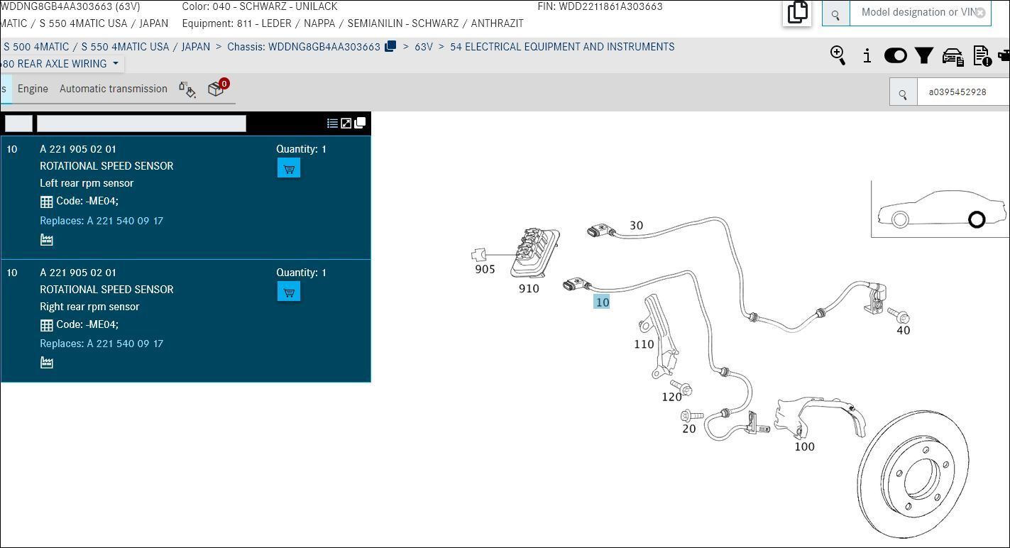

Can you please help me with the abs sensor part numbers and how many of them I need! I'll try replacing them though U don't have any errors associated with them sensors :-(
thank you.
Old Dec 23, 2021 | 08:54 AM
konigstiger's Avatar
Posts: 15,901
Likes: 4,632
From: North Scottsdale, AZ
'71 Pinto
Front left & right 2219057500, rear 2219050201.
