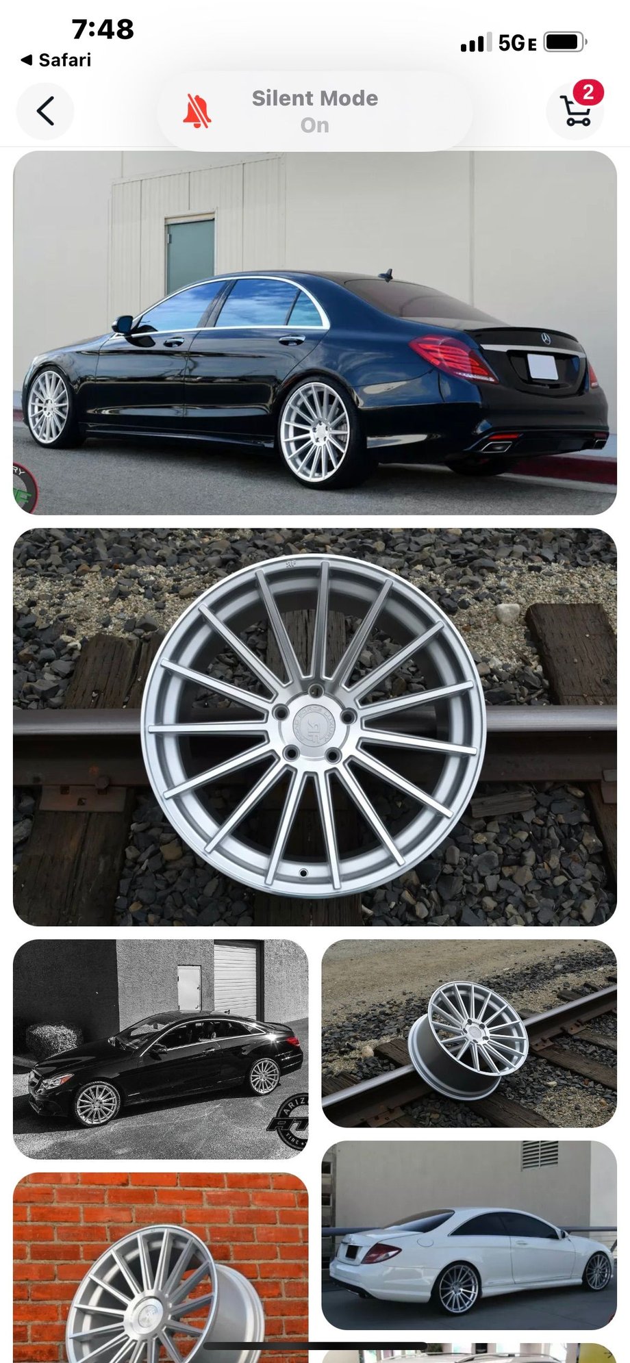

thank you for all the information. I believe my wheels are replicas. With that say I needed to change the wheels cause the car was boring with the blk/blk. Here is the wheels I am getting. I got a decent deal. $959.00 free shipping.
Originally Posted by WHPH28
You can look online for the specs for your current wheels or post a pic and someone may know. I'm guessing they are +43mm F/R and most W221 replica wheels are +35 so they will sit closer to flush. You can look inside the wheel and it has the model number and offset stamped on the inside.

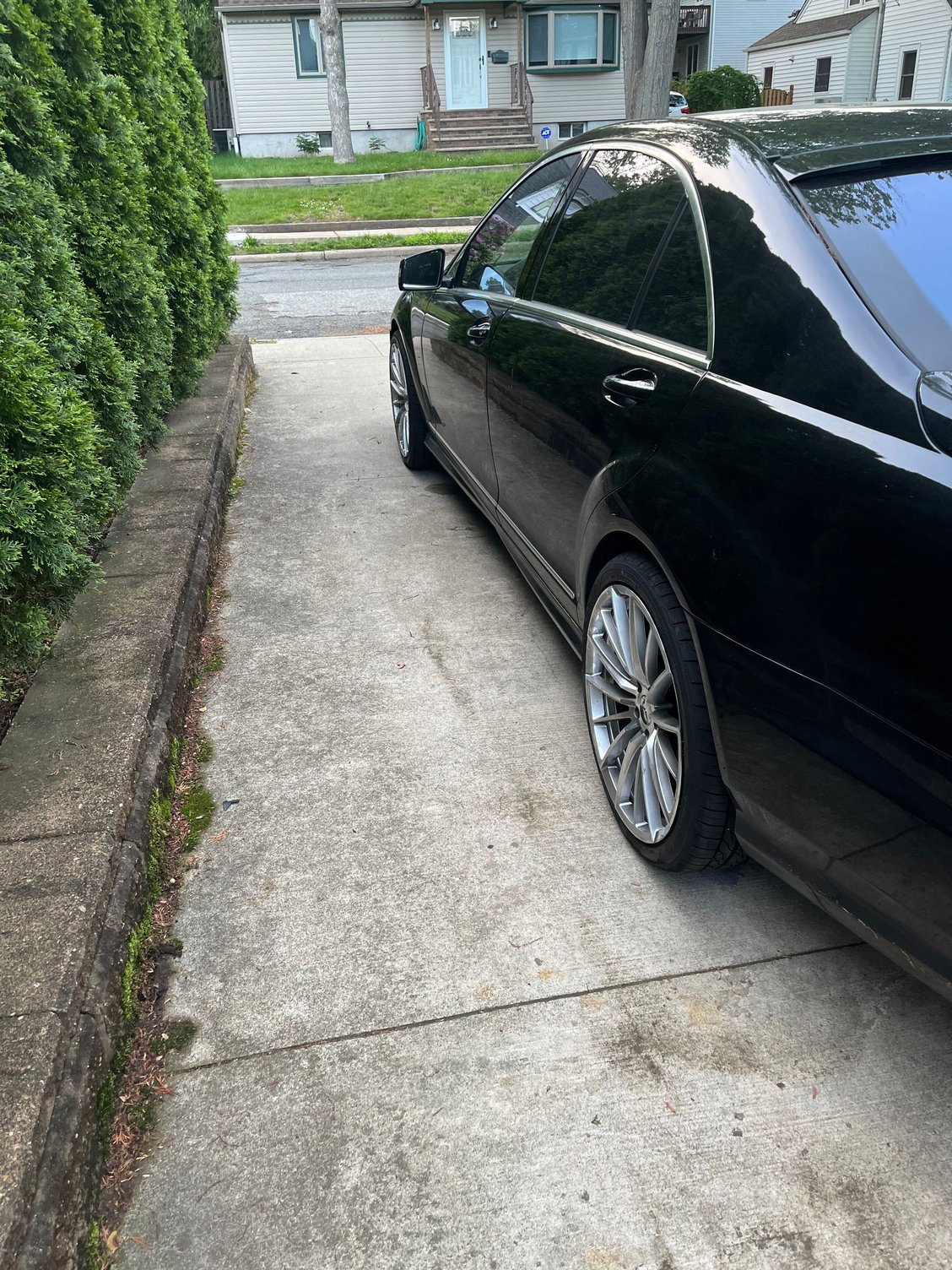

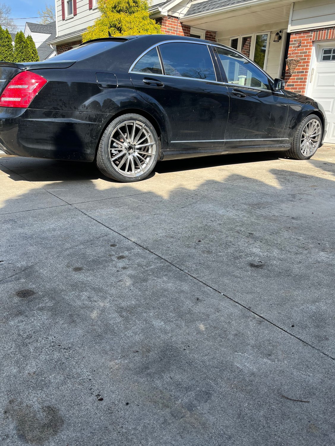

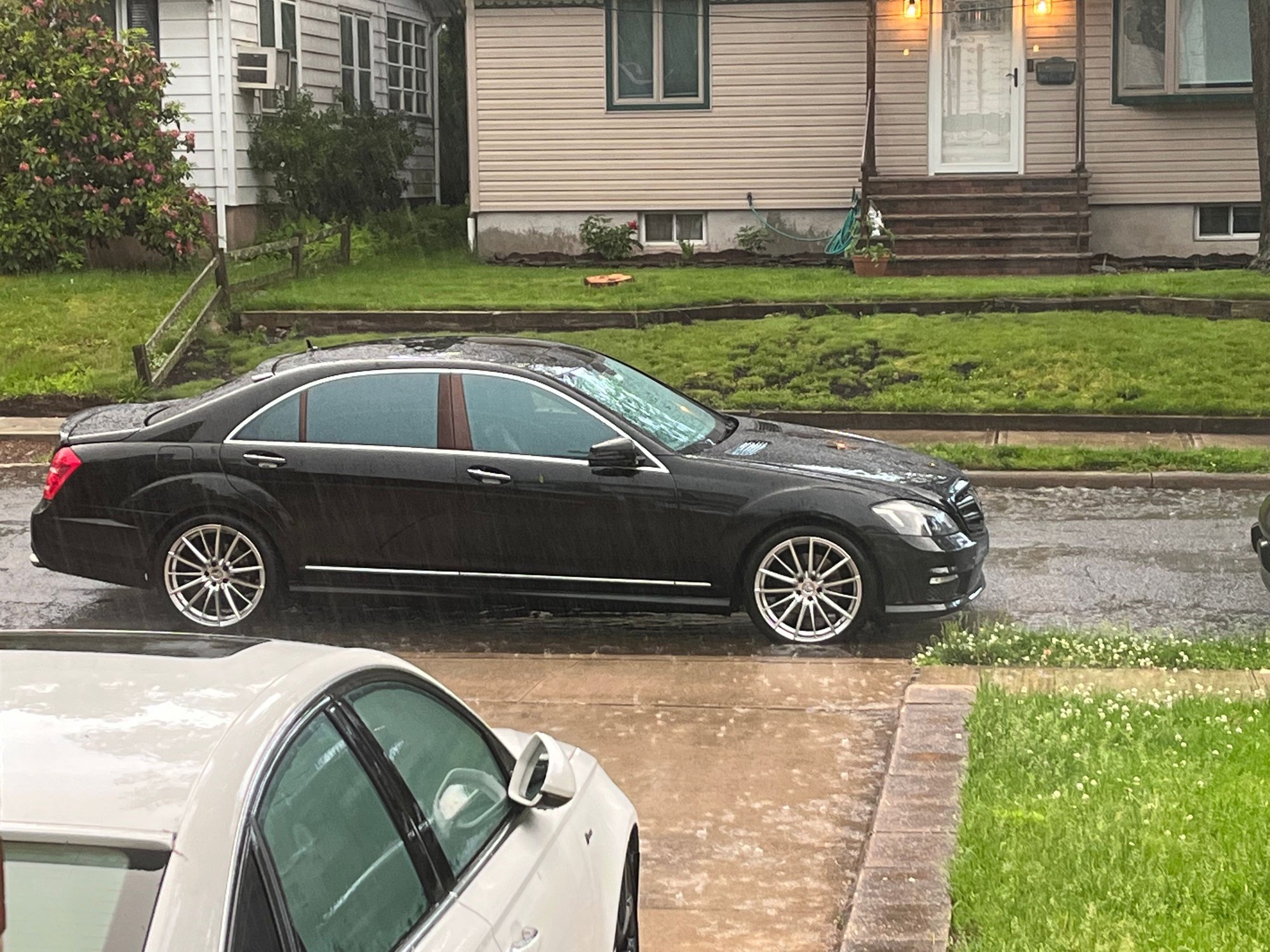

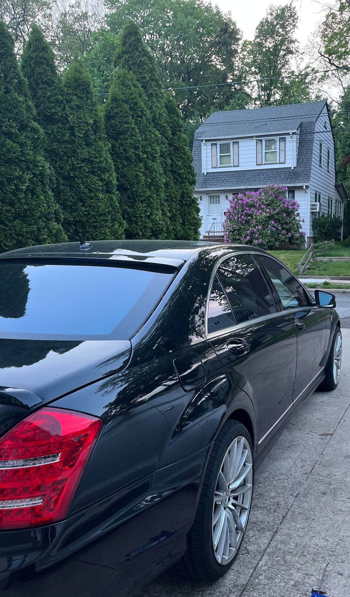

Tt
there go
