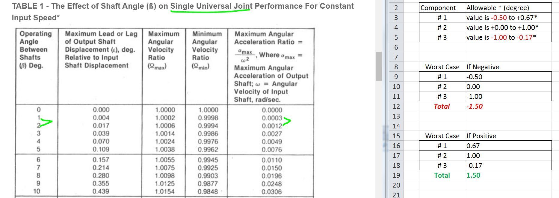

Whatever misalignment occuring between : Tranny output >>>2 piece propeller shaft with center bearing + flex discs >>>Differential ( has a mounting too ), it is only 1/3 of the total equation.
First 1/3 is controlled by engine mounts
Second 1/3 is controlled by tranny baby small mount.
If you suspect any misalignment to the 2 piece propeller shaft region, not wear and tear on spinning component, I am speaking of purely misalignment........ sort out the 1st and 2nd upstream component first.
Flex Disc or Guibo will outlive engine and tranny mounts by a few times over.
This is a decently good read : https://www.mbwholesaleparts.com/con...-Vibration.pdf
Arrie wrote :
So, I did not drive my car last week as I thought there might be an issue with the bearing in the gearbox or the center bearing but then on Thursday I went to driver it to check and it really sounded like something is dragging on the drive shaft. On Friday I went on a 700 miles trip with it and this convinced me that it is not a bearing but something touching the shaft.
Today I went under the car and noticed how the aluminum heat shield is very close to the shaft at the far end of the shield. I would say less than 1 mm between shield and shaft.
Now, assuming if the sound shield did not get its position disturbed, doesn't that mean there is a possibility that the shaft is the one getting closer to the sound shield ?

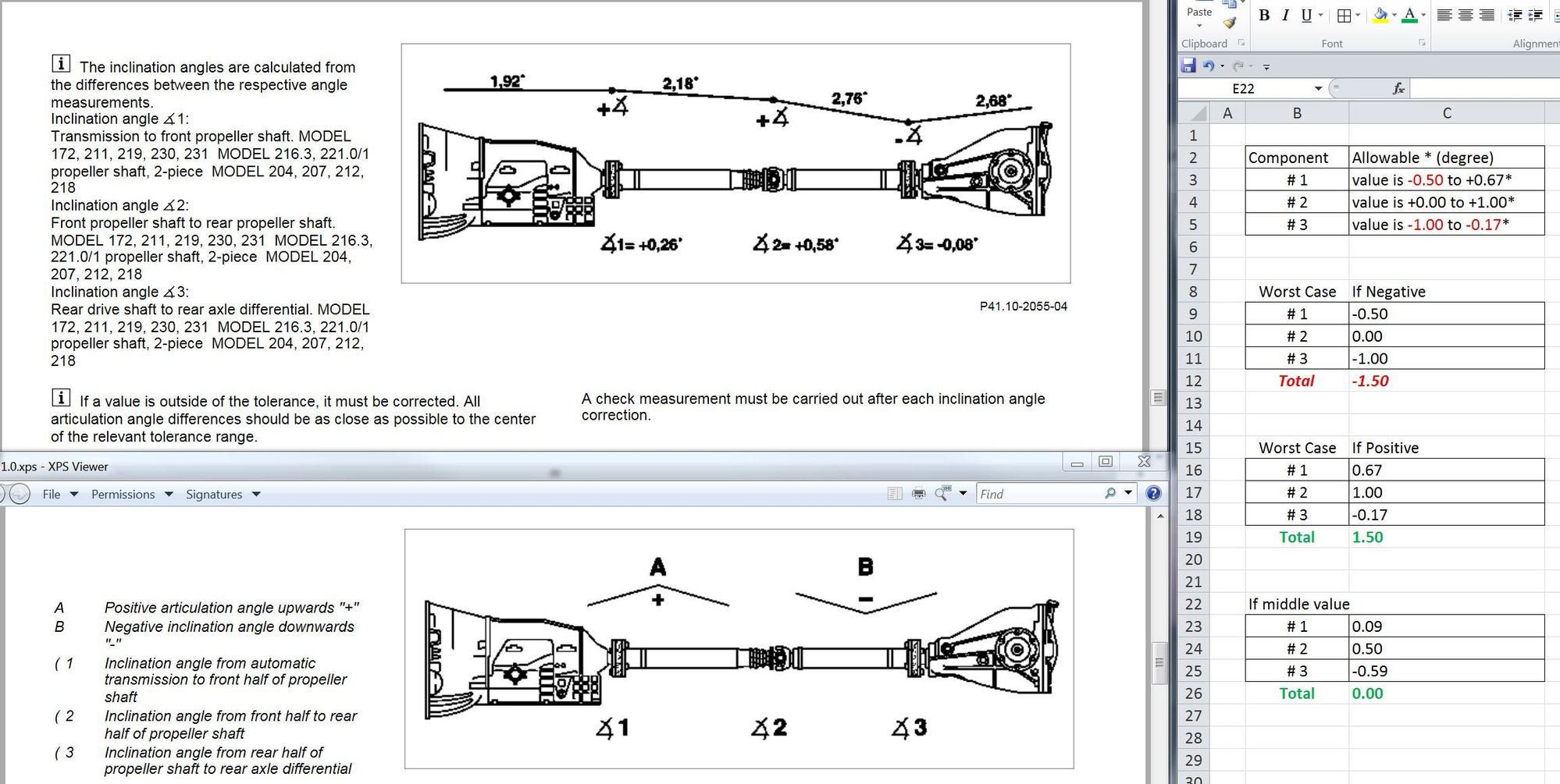

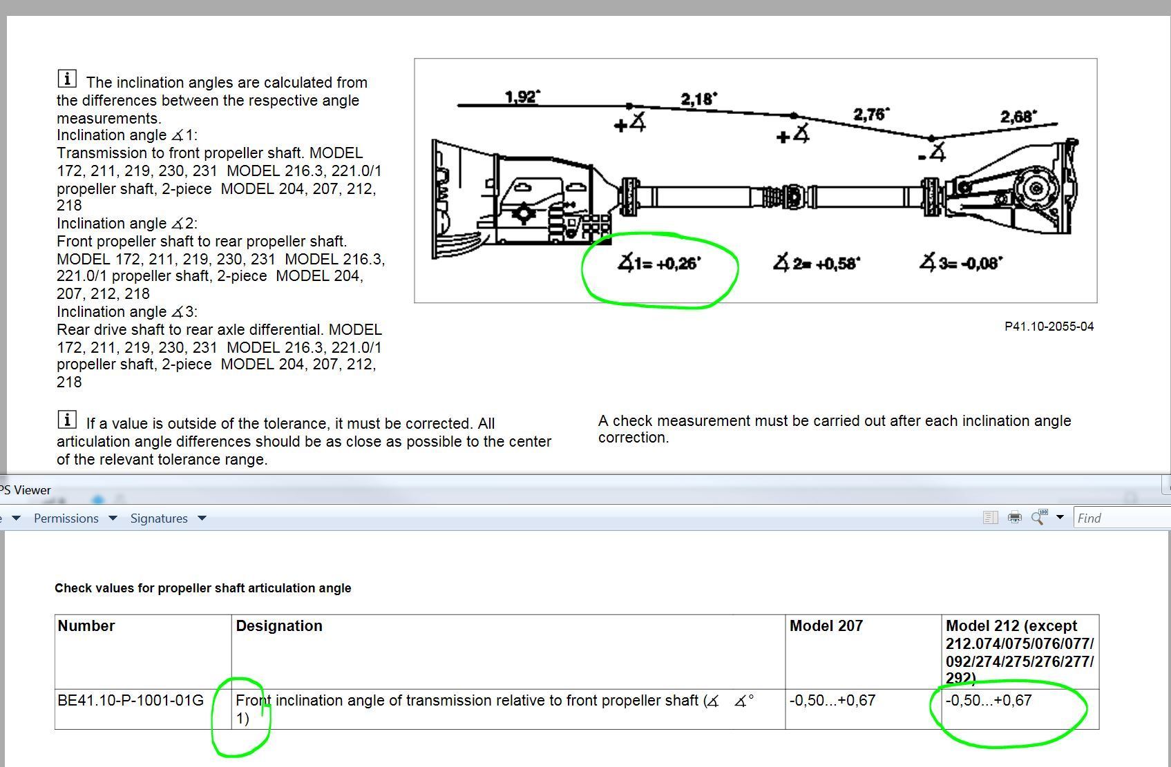

This is from a W212, but concept is the same. Measuring these values is not possible for us. The tools and the jigs involved are way too expensive, but at least we get to know 1.5 degree positive or negative is the limit.
So why 1.5 degrees allowed ? Its seems it is still an acceptable misalignment value if based on Single Universal Joint, where we use universal 2 joints ....so more forgiving I guess.

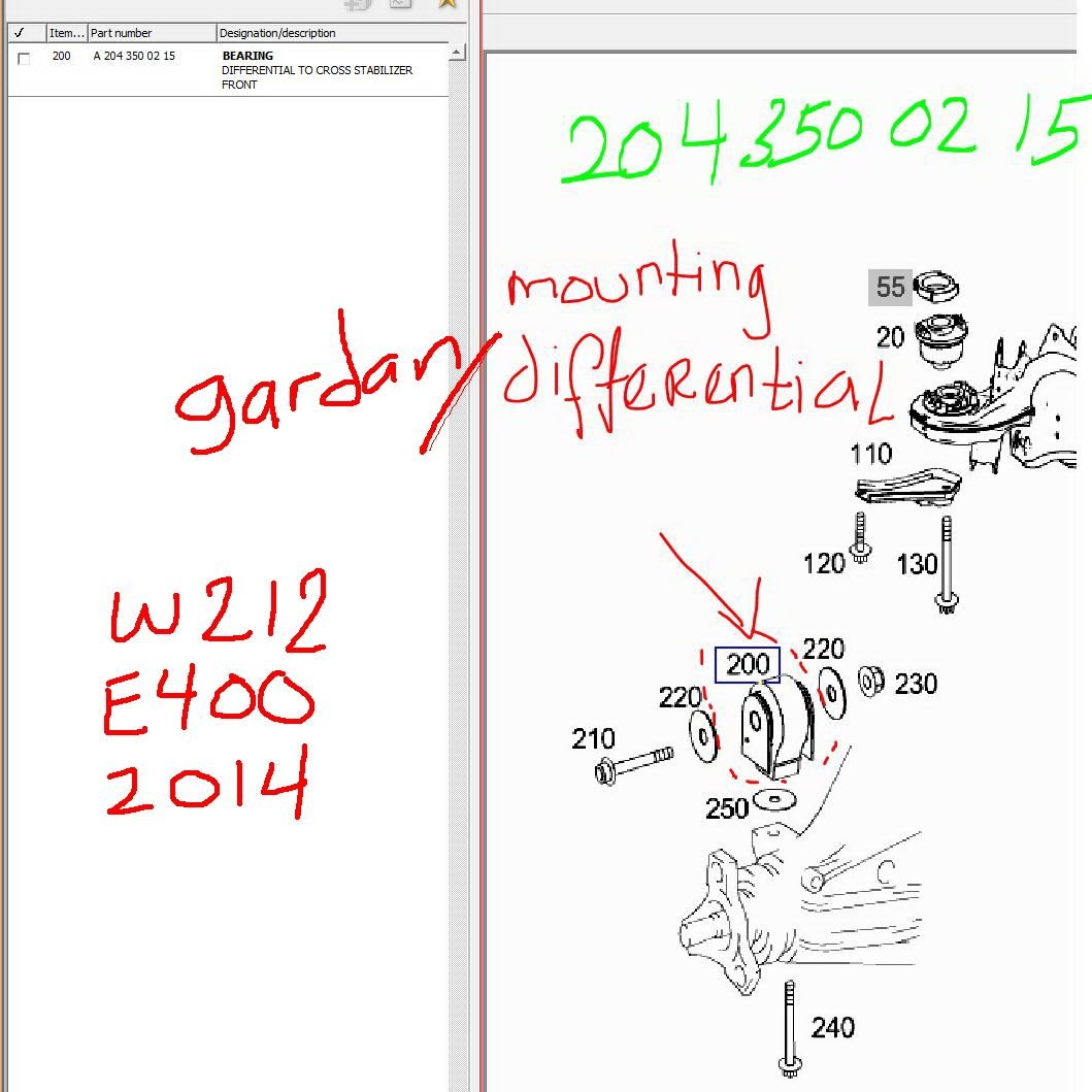

Yes, there is a mount for differential too, but it is not as soft like the tranny mount.
Hope the input helps.

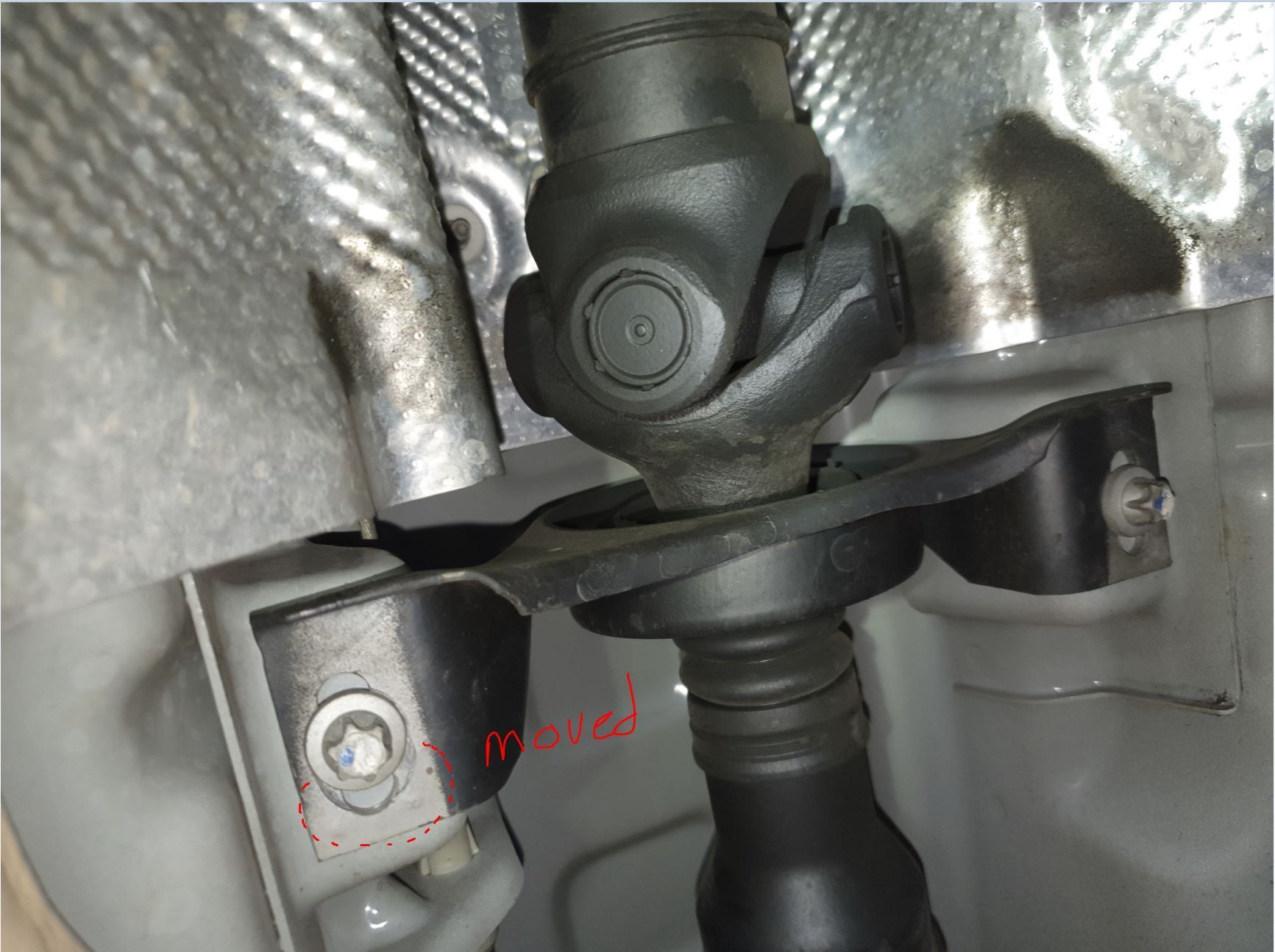

My vibration issue most definitely is drive shaft related and I think I found out what it is, i.e. the center support bearing rubber mounting.
When the vibration was quite bad before I did anything I had the engine mounts replaced. This made huge improvement but I still had some that I don’t think a S-class Mercedes should have. My E-class don’t so this one should not either.
When my dealer replaced the flex discs as they showed some dry-rot cracking, I asked them to check the center bearing. I was invited to come look at the bearing still in the car and I noticed how easily it moved around with very light force. I questioned this but the mechanic said they are all like that from new.
When I got the car back I had this rubbing sound and it appeared only during slow down when some engine braking was present. No sound when engine pulled the car at all.
Above behavior tells me the drive shaft is moving sideways in the bearing rubber support and made the shaft touch the heat shield that the mechanic obviously installed closer to the shaft. I pulled the shield down and it took care of the noise issue.
But the slight vibration is still there but not quite always. When it sometimes is good the car is so smooth and I believe this is when the bearing in the rubber support happens to be in the correct position.
I believe this rubber bearing support is the culprit for lots of vibration issues when usually tires are blamed for it.
I will have the center bearing and holder replaced and I believe it will make my car smoother than ever. With replacing these parts I have all parts new so it should be good.

No news at this point.
Finally got this done. I don't know how much this had to do with vibrations I could feel. It probably was a combination of issues. But, it is done now.
Biggest job for me was to get the car jacked up high enough to fit under it with a creeper. Would be so much easier if I had a lift to get the car up.
The first part of the job was to remove the rear tail pipe sections, then to remove the rear portion of the plastic bottom shield and then the aluminum heat shield sections. At the ends of the tail pipes I find butterfly valves actuated by vacuum or pressurized air. Does this car use these valves for cruise control for controlling car speed down rather than using brakes when slow-down does not need to be aggressive?
For the drive shaft removal after removing the two bolts for the support bearing bracket and the four bolts for the flex disk I first pulled the rear shaft half out from the flex disk and then separated the shaft by just pulling the rearward shaft half out. This saves lots of work as to be able to get to the flex disk at the transmission end you would also need to remove the quite massive cross member that acts as the transmission support. I was not sure if it would be safe to just remove the cross member without supporting the box so I elected simply to separate the drive shaft parts. Before this I marked the parts so I can get it back together the same way.
Center bearing seemed to be in fine condition but the rubber support had compressed at the bottom so the shaft had been running at about 1/4" lower position than it was designed to do. Now, does this cause vibrations I'm not sure. After putting all back together the car drove a bit smoother but still had vibrations at 65+mph speeds. Had the tires balanced and now my car is smooth.
My car had vibrations also on idle and these went away with replacing the cam shaft position sensors. This also helped with vibrations while driving. Replacement of these sensors was perhaps the biggest help. Wheel balance was also quite big. I have had wheels balanced 4 times before but the vibration did not go away but this time it did. May be that other vibration sources kept it vibrating while wheels were ok.
But, now the center bearing is not a suspect anymore as I know it is new with new bracket. If I get vibrations again I can go after the most likely source, i.e. the wheels.
