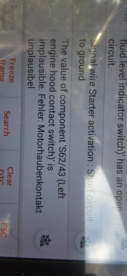

Hood open problem-----Did a scan
Ok great....because we've closed the mechanism with the hood up by using a screwdriver and see the contacts are touching but still says hood open...we wanted to see if the sensor was bad or the hood latch..still getting same result....also switched the driver side latch to the passenger side and same result.
Just did a scan and got this
