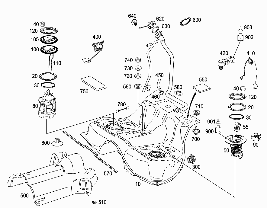

My car is a late 2006 and I was surprised to find that the steel petrol tank had rusted into holes where the heat shield/sound-deadening panels attach to it. Had to remove all the rear suspension/diff/exhaust/prop etc to get the tank out to weld it (new tank £3020 - supply only!!). This car has spent it's life in the UK where the roads are salted each winter. Might be something worth checking though, depending where you live.

That's a great tip. Last year when I bought the car I douched as much underneath as I could with CRC Rust Inhibitor (Project Farm found it scored top marks in a comparison). I will try to get under there soon and pay attention to that area.
I have to say I am shocked the tank is steel. I thought most cars went to plastic in the 90s.
had my MOT today - I thought I was looking at the petrol tank - its plastic ???

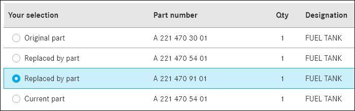

Looks like 221-470-91-01 and lists for $1,460 US. My particular dealer internet price is $997.50. But I have no idea what the material is. I really hope it isn't steel...
I was amazed it wasn't plastic.
Everything from the main dealers in the UK seems to be approximately twice the price I see stuff for in the US, but most places don't seem to want to ship to the UK. Got to be a business opportunity there! For instance - I replaced the subframe bushes while it was in bits recently and had to pay £130 each for bushes that I saw advertised in the US for $59 - both the same MB part.

ummm, maybe what I think is the tank is something else
you know ethanol is a killer for metal - deteriorates petrol in 2 months, absorbs water and grows bugs that excrete acetic acid
