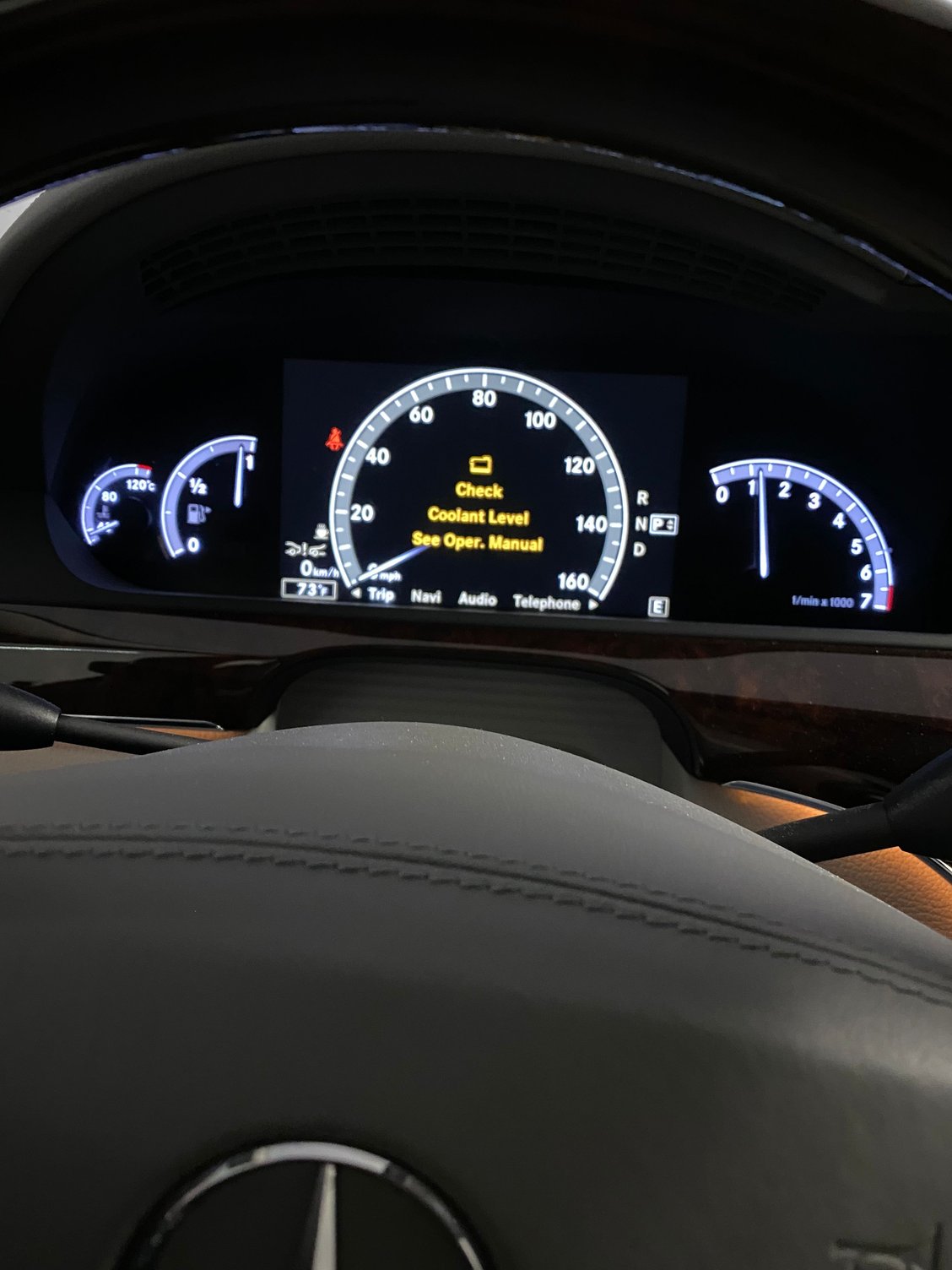

Hi all, suddenly got this coolant warning. The coolant was flushed and topped off about two months ago. I drove the car around after dismissing the warning for a few hours and the operating temperature stayed at 89C which it has always stayed at. Is this an urgent issue? And what is the worst possible scenario?

when you get a warning of this nature - the correct thing is to validate the message, its never to just continue the journey
a replacement engine is going to be (depending on specific one you have) the wrong side on $10K and at least two weeks minimum without your car, never mind being stuck somewhere for a few hours etc.
So the first thing ought to be to Stop and verify it
1) the coolant bottle is full
2) the top hose full of coolant and when you repeatedly squash the hose you feel vast quantities of coolant moving and not air (don't stick hands in fans or drive belts - turn things off)
3) there is no visible white patches all over the engine and engine bay (of cooked antifreeze that's leaked and dried out)
4) that there are no visible traces of coolant leaking out
5) check engine oil level and colour
that list is a few sensible steps, that take much less than 5 minutes at the roadside - if these come back normal, proceed gently, monitoring gauges, other warning messages, and engine behaviour and smell. An over heating engine will feels slightly under powered, will have a funny erratic idle and start to smell hot and bothered and may stall with low load.
Once the coolant level is depleted, the reading of the engine temp gauge can no longer be relied upon, there may be no coolant around the sensor to give the correct reading
as there was work done and the things are hard to get the coolant around and all the air out - it might be trapped air - or a sensor failure - but driving on is a recipe for wasting time (not saving time) and can empty your wallet unnecessarily

Just add coolant.

I would not dismiss a coolant warning! A control arm or a ball joint? Yes no problem but a coolant definitely not. Like Botus above stated, that would be a recipe for disaster.

Was the cooling system pressure tested before refilling? M278 is notorious for turbo coolant lines leaking....

Turns out it’s a leaky water pump. Anyone know what a reasonable quote is for this repair?
