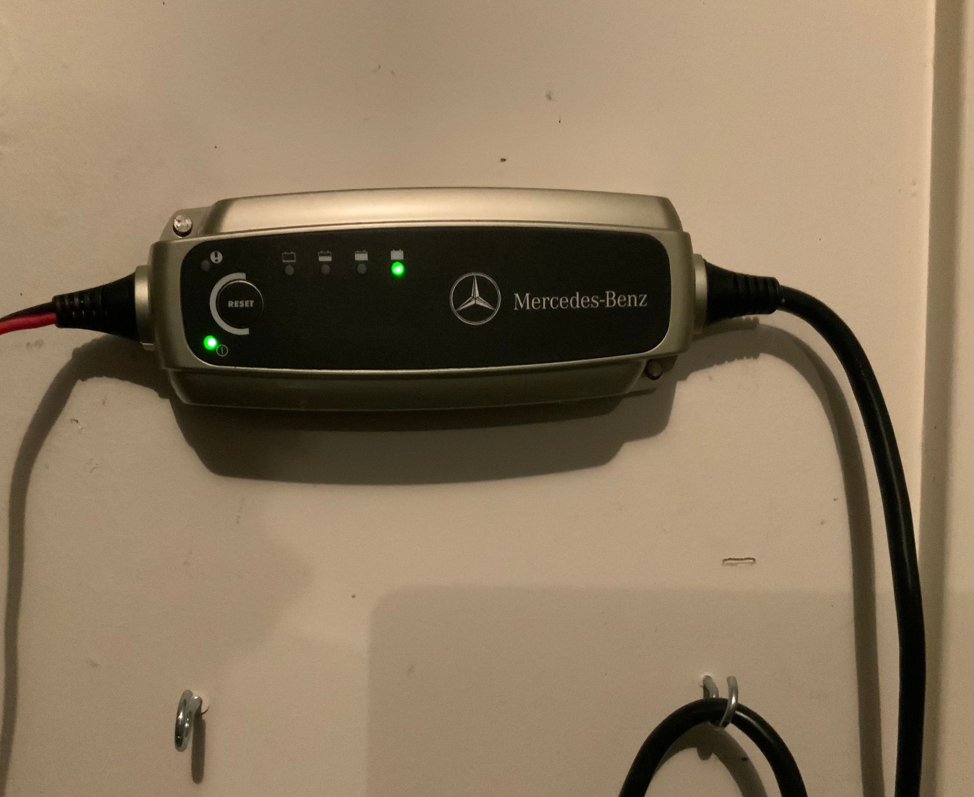

We have a CTEK too but a different model. It's been ages literally since I used it but as far, I remember, I was just connecting the cables and select AUTO mode. The device was doing the rest of the job for me. The image you posted shows current status of the battery charging and it suggests to me that your battery is in good condition assuming it skipped the level of indicators faster than usual

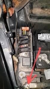

Thanks BOTUS…someone sent me this pic…so if I connect the CTEK + lead to the post indicated and then the other to earth will this maintain both batteries or just the large rear consumer battery? Thanks for your input!

under the bonnet - on mine I have this pre fuse box 2215400850 under an 8" long black plastic cover beside the battery - the positive connection for your charger fits to one that's a lot taller than all the other posts - the one with the unthreaded part and the one furthest forward (nearer the headlight - opposite end to the normal fuses) as per these pictures - but sits with the posts straight up in the car. The other lead goes to the negative battery terminal - it should maintain the charge to both batteries

Yes…looks like the same as mine. I’ve connected the positive to the front (tallest) post and the negative to the negative terminal on the start battery. Just curious…will this charge both the start and the consumer battery or does it bypass the start battery and only charge the consumer?

I just finished editing my post (plus nicer pictures) - its supposed to keep both batteries happy

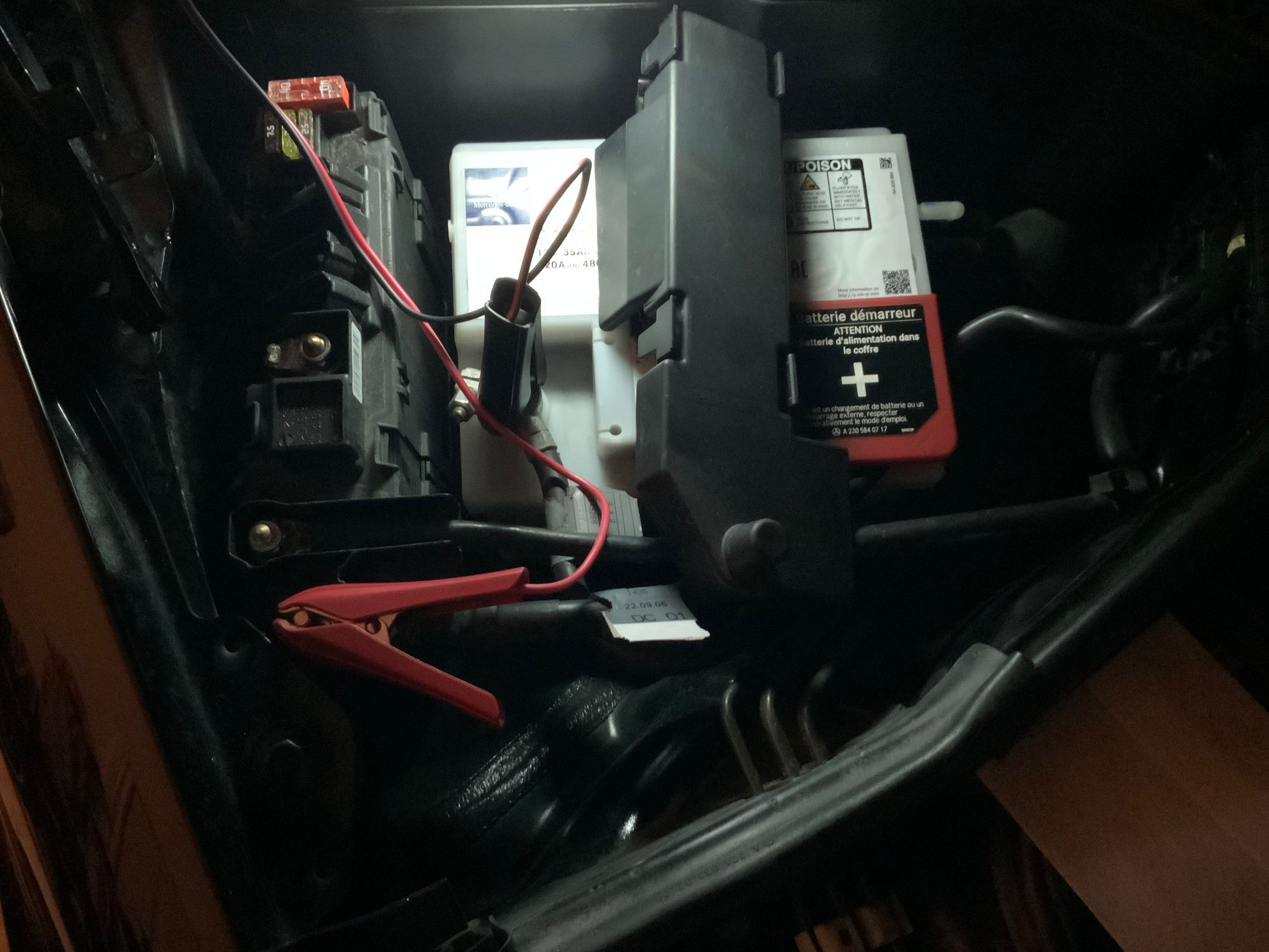

Here is my set up…I’m able to run the wire out near the windshield and close the bonnet. The car is also in my garage so I can leave it unlocked. Thank for all your help! I really wanted to ensure that consumer battery (which is quite pricey to replace) was in good shape in the spring! Cheers

looks odd on the wrong side of the car
