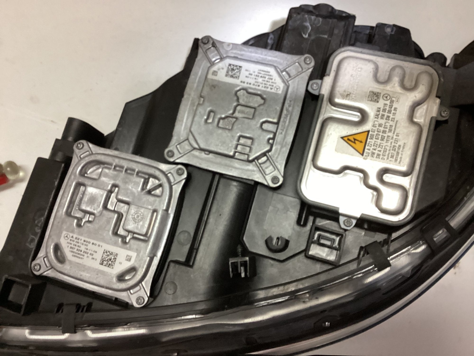

Thanks, I pulled the headlight out by dropping bumper…it was out of alignment so 2 birds 1 stone. Removed both side assemblies and swapped out modules and problem still on right side- stupid me should have plugged entire left assembly into right side and seen if it worked as plugs are the same. The hardest part of Mercedes is the dam plugs are so tight and push clips to release so small, anyway I will try again tomorrow as second disassembly should be much faster…learning curve done. I saw no service hole to get to cornering bulb unless it’s thru the module wiring hole…need to investigate some more - ran out of time.
much appreciated all the help.

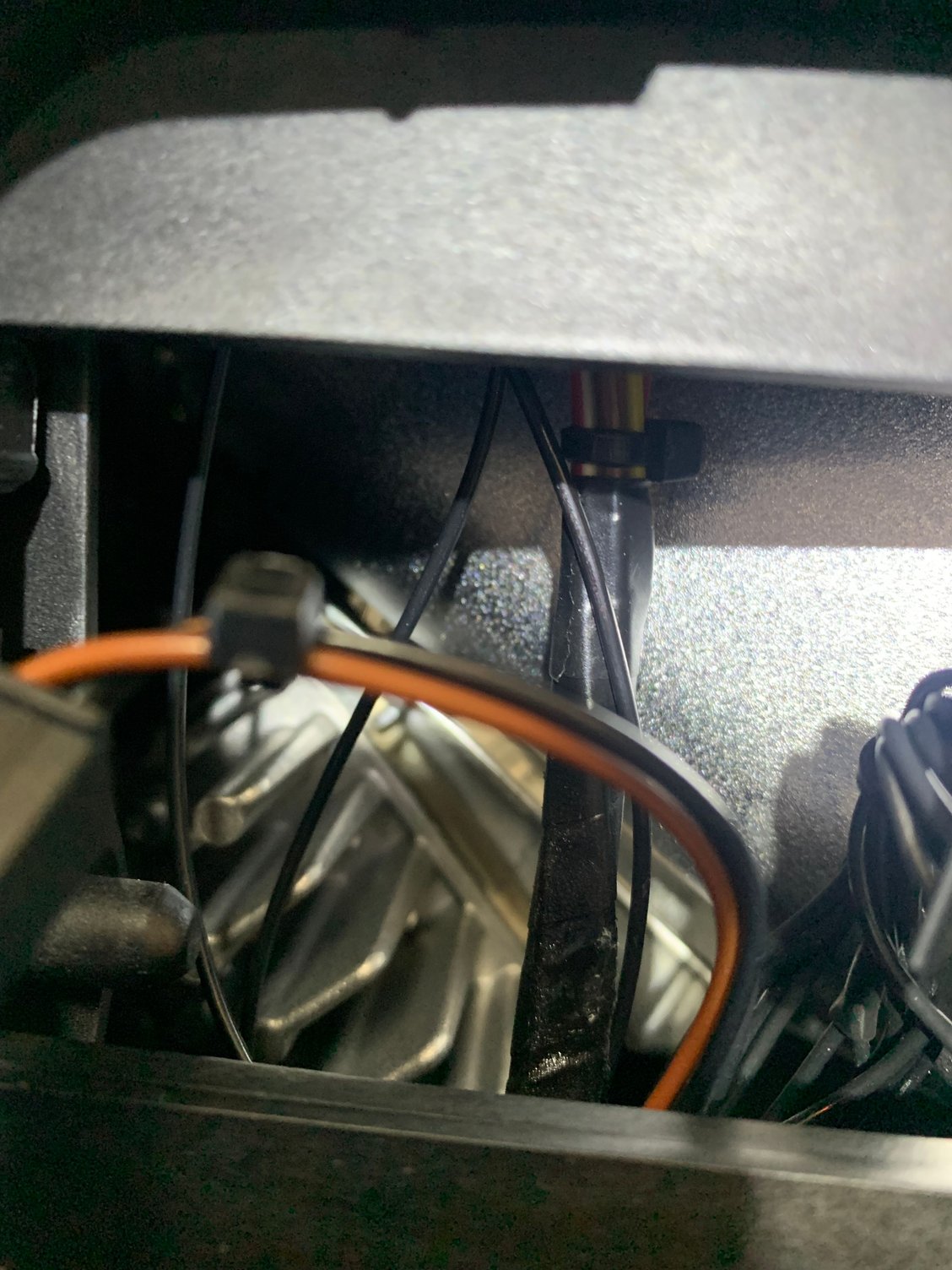

Confirmed bulb not serviceable. Anyway to emulate bulb to fool canbus to not throw message? If so does anyone have wiring diagram of lights insides for facelifted model? 🙏 thanks
calling around to indies in south Florida today to shut feature off - I am to OCD with car to have any warning messages. Also if anyone has recommendations for indie in south Florida then please advise.
regards,
