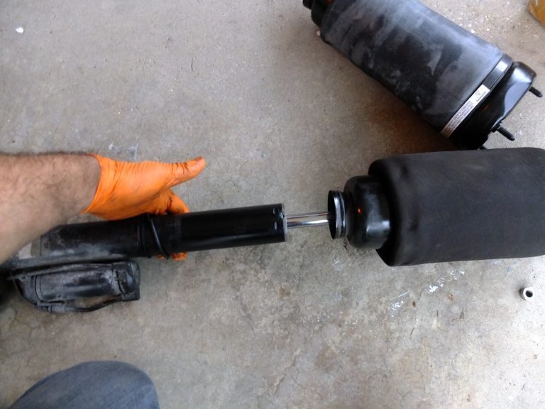

they do make them....
https://www.mercedesmedic.com/merced...placement-diy/
mind u at this price you get new dampers and 2 year warranty ?

Our air springs are an economical solution to repair your air suspension strut and are designed to ensure easy replacement without special mounting tools. If your shock absorbers are still in good condition, replacing only the air springs is a more budget-friendly option of fixing your air supension struts.
Aerosus air springs are made of high-quality elastomer materials and covered by a 2-year limited warranty and a 30-day money-back guarantee. The rings on the air springs are crimped using a special technology for dependable operation and leak-free performance.

My thought is if the thing has enough wear/age on it for the air bag to fail, replacing the whole thing is not a bad idea (just not with aftermarket).
