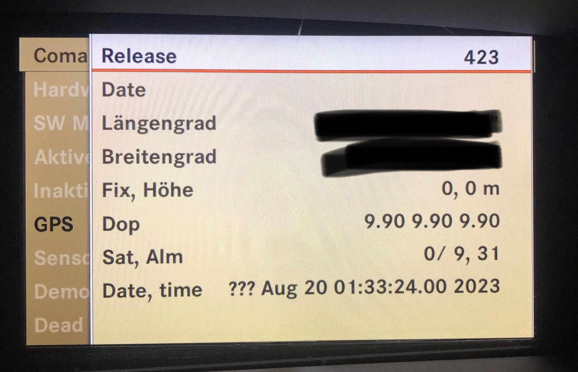

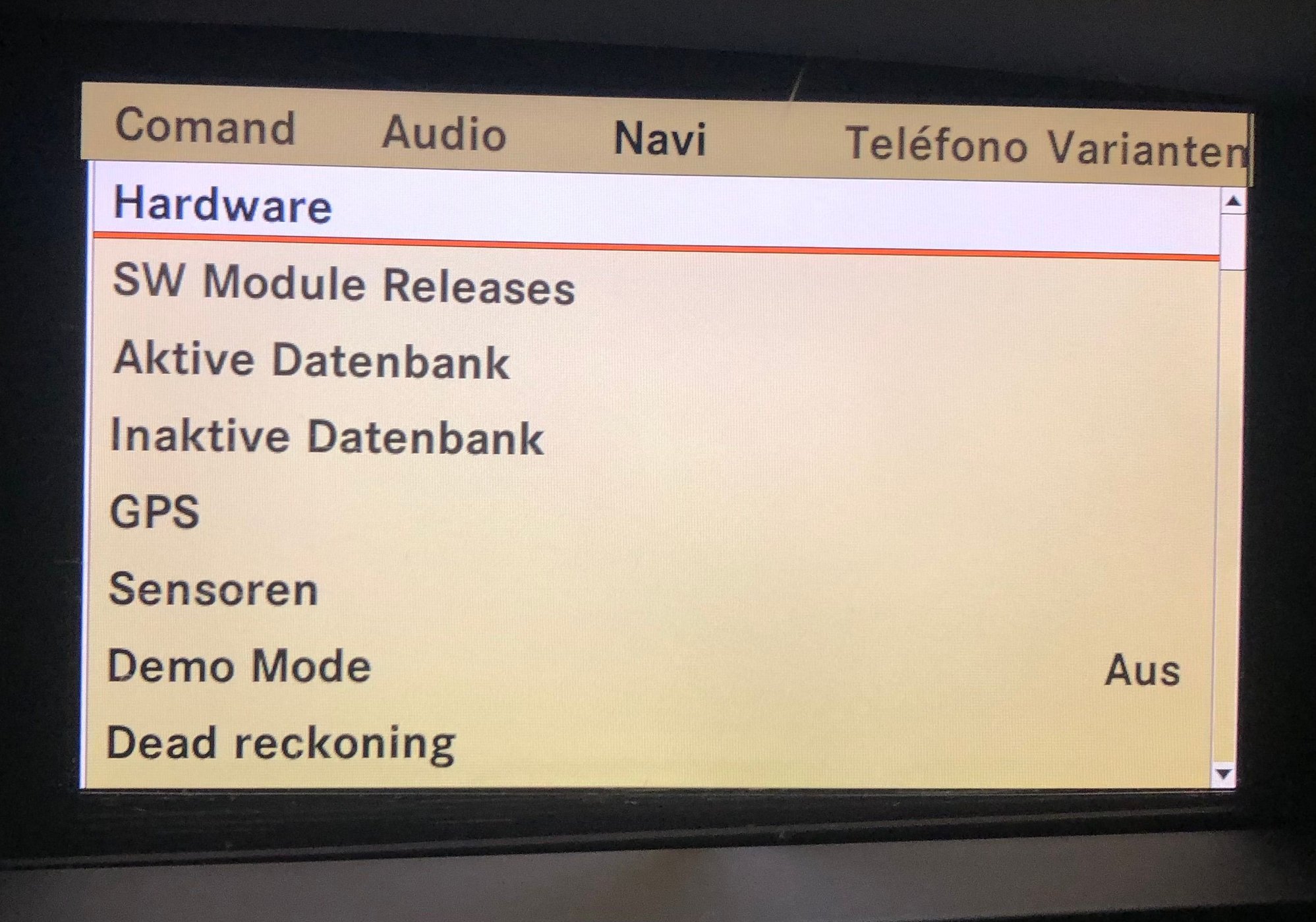

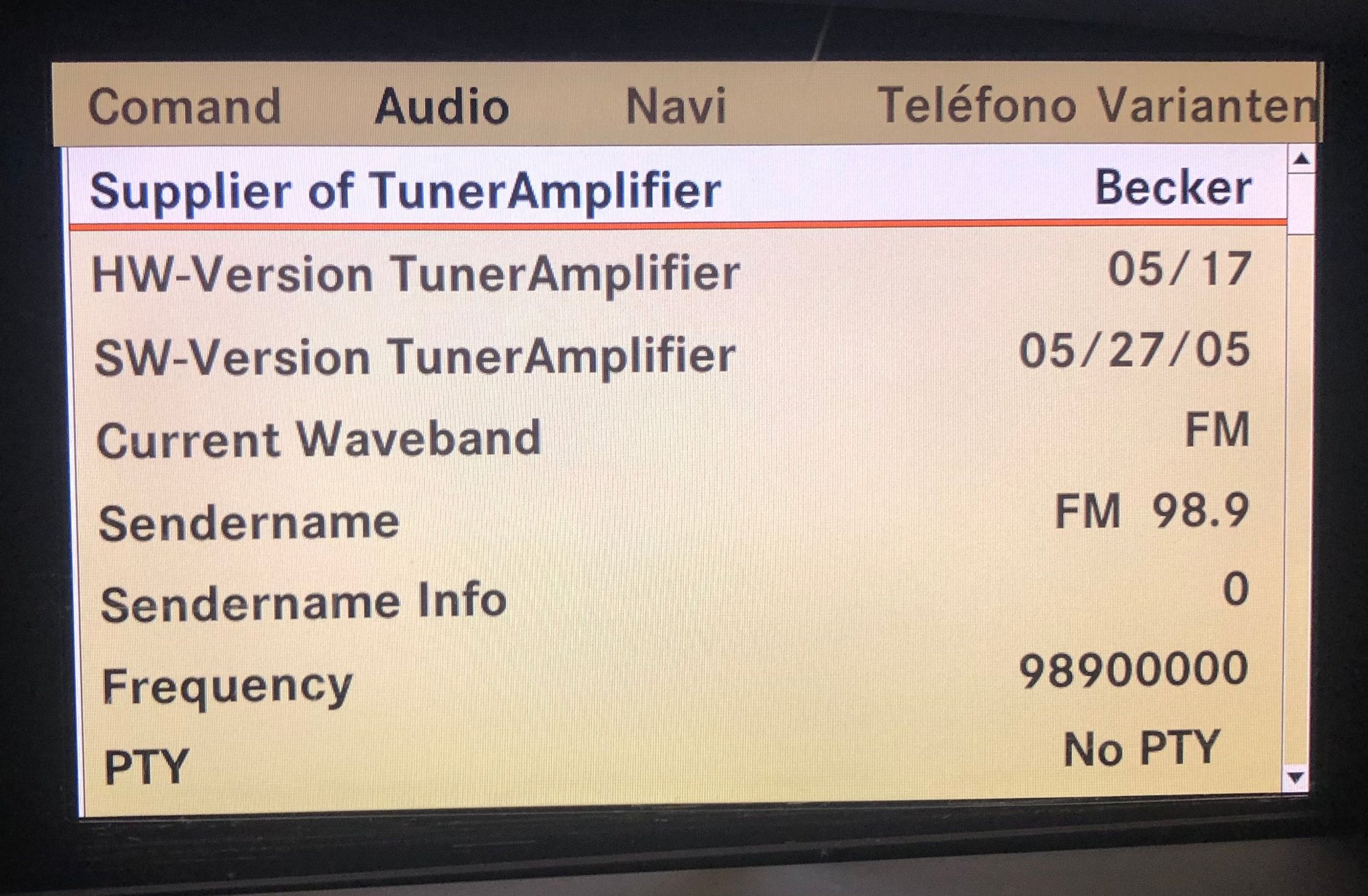

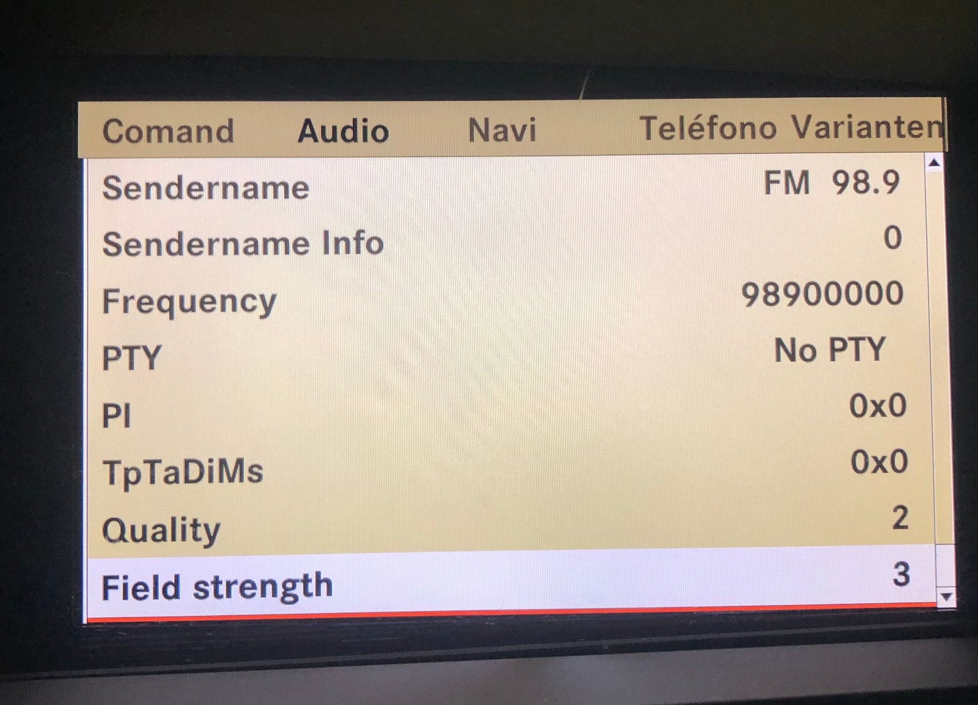

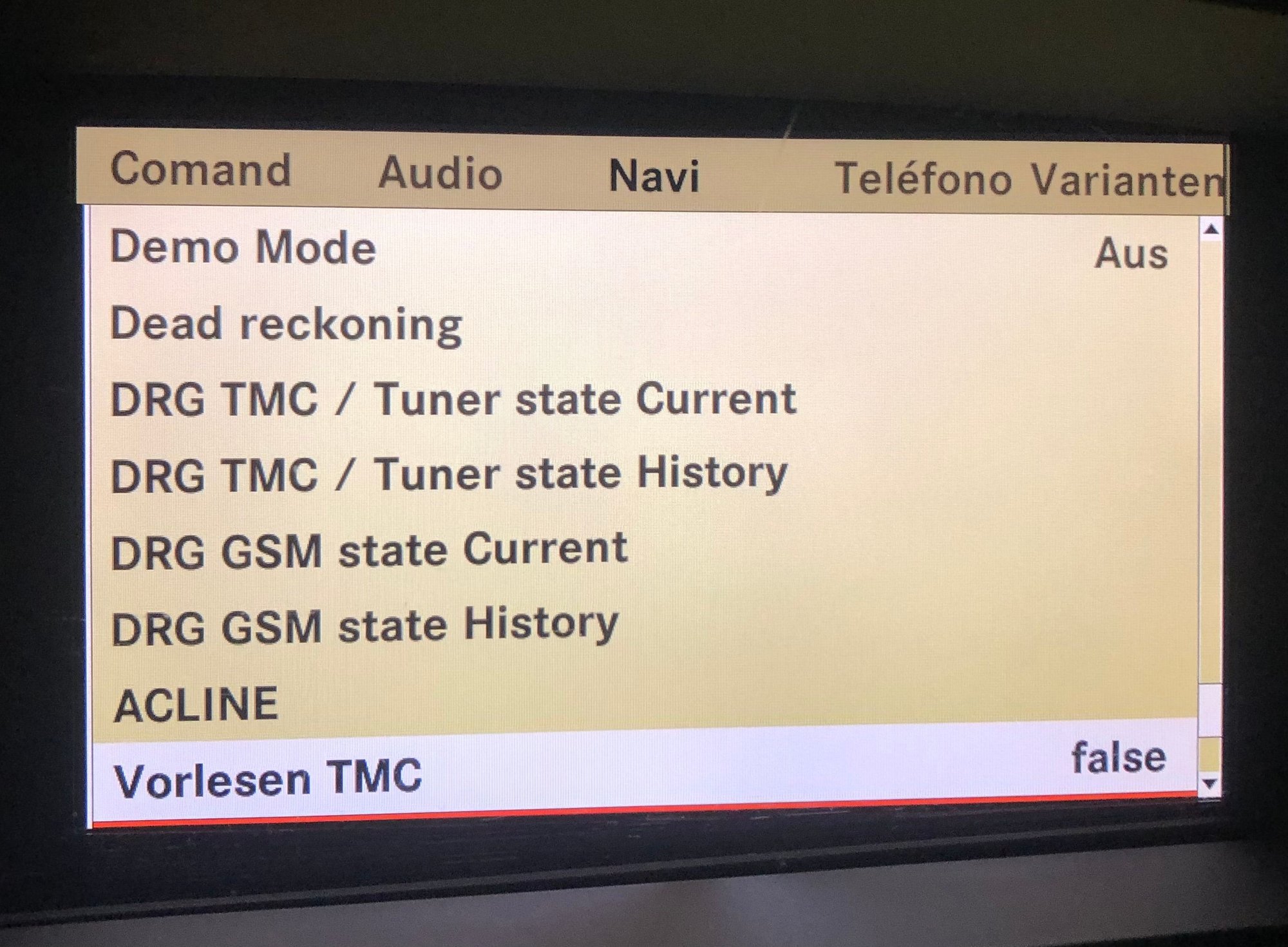

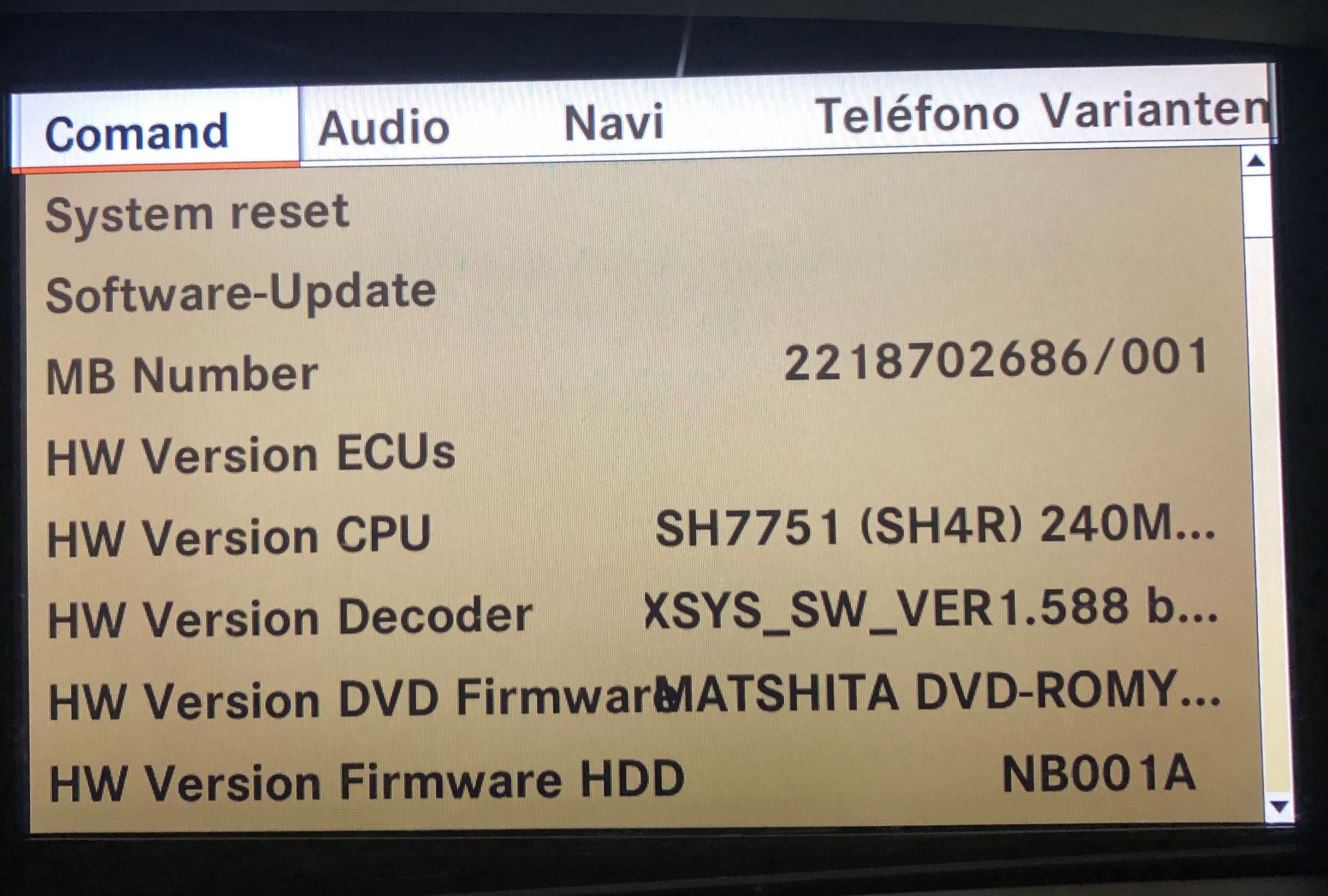

Old Aug 20, 2023 | 07:21 AM
Oderfla's Avatar
Joined: Oct 2019
Posts: 95
Likes: 8
mercedes s 500 w221 año 2005
Hello
Hello, here I upload the information that I took out of the car yesterday when I got home from work. Here it was 03.24 in the morning. see if you see something strange or different that could cause this problem. thanks again everyone greetings

Old Aug 20, 2023 | 09:02 AM
BOTUS's Avatar
Joined: Aug 2014
Posts: 5,317
Likes: 1,673
S500
so from the bottom of this photo , question marks seem to show up - its normal at certain times of the year - when in daylight saving mode from the very limited checking I have done post clock fix update
then as satellites base their time on GMT but call it UTC, you are two hours off GMT (which its supposed to be as Madrid in the summer = GMT +02:00) thus for the time you said you took the picture, it looks like the Car is seeing the correct time and date
is the analogue clock still being odd ? if so for me, next I'd park outside switch off the engine and remove the key - go in the boot and to the right of the spare wheel you should find a black flat earth cable bolted to the side of the boot with a red painted 13mm headed bolt - remove this for 20 mins and then reconnect (will need to reset windows and sunroof - at any point later to re-enable the anti-trap features). Start the car and see if the clock and the car find their way on the time - and remember how to work correctly going forward
