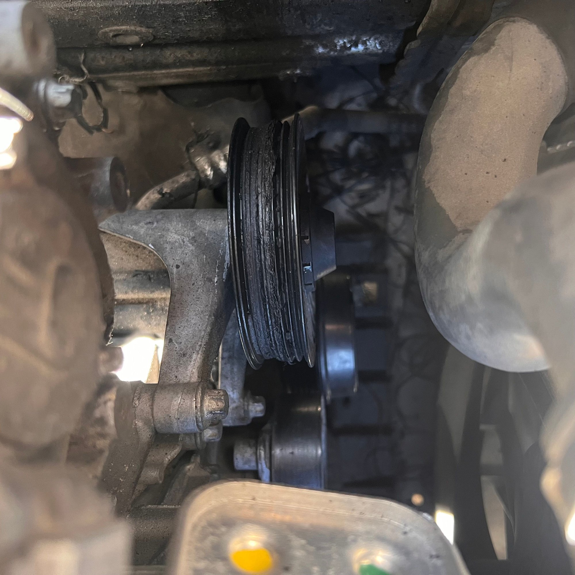

I am trying to figure this particular pulley that I think is positioned near the power steering, but doesn’t appear to be power steering on this 2008 s550 4matic. The serpentine belt unfortunately snapped and damaged some idler pulleys so I am trying to replace them.
The one in question is the picture below.
I looked at some diagrams that say it’s the power steering location, but it clearly looks like a regular pulley. So I’m a bit confused on what I should look for on replacing: is this just a regular pulley or the power steering? Also a part number would help if I can just replace that pulley. Thanks!

I'd order something like the Continental ADK0012P kit which includes the belt, the tensioner and two pulleys. I don't think the belt failing caused the pulley to fail - the opposite. Replace everything.

You should also replace that AC pulley as well.

Yeah I did the whole belt/pulley kit chasing an accessory noise before learning it was the A/C pulley. Not that difficult but sourcing the correct diameter pulley is difficult. The one I ended up with was an eBay special and had a slightly larger diameter (so compressor spins slower). Haven't noticed any ill effects though. These cars have quite large A/C systems so there is probably capacity to spare (which would really only impact idle conditions).
