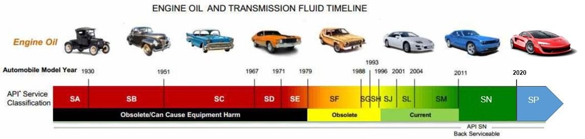

Yes. In the big oil debates, there’s a lot money in it, for them , but for me it breaks down to simply two things:
1). Combustion engines can serve up toasty temperatures on a hot day in the desert. Depending which testing and oil types, the internet articles about oil vary for synthetic oil breaking down at 450F to 700F and Dino at 250F to 300F. Winner: synthetic.
2). The modern day evolution of the additives separates the men from the boys. Synthetic additives have evolved and Dino oil got left behind with the lawn mowers, sort of (great additives but core Dino oil breaks down much before synthetic). Winner: Full Synthetic European and North American Car Formulas. Hometown boy chooses Mobile-1.
Articles speak to when Dino oil makes sense, Botus breaking in an engine when synthetic is too slick to break in or someone saving money to purchase more beer. Just have to change Dino oil more often, conversely, less beer.
My good friend highlighted the fact back the 60s his Dad changed his Dino oil and filter every other month before it turned dark. When they rebuilt the motor, the insides looked brand new. That there proves Dino oil works good just good as synthetic, and it’s one third the price! Must have only drove it to Church on Sunday.
Now that I reflect back, it’s starting to look like that test was rigged!
In a nutshell, if it meets or exceeds MB 229.5
l push the I believe button, and use it!

got a response on the 222 thread I'd found using search, before I got back to this one... seems they too know about fun with Knock !
Originally Posted by Baltistyle
Agree with most here BUT the newest rating is SP… I think the Takeaway would be that if you are buying an SP spec oil to deal with LSPI, you are not going to want to add another zinc additive on top, especially if there is no tune, and there are cats.
Originally Posted by Senecat
top end rattle when running recco MB 229.51, but a 50 50 mix of 229.51 and 229.52 the noise vanishes and has stayed gone thousands of miles later....
So that specific/precise of a formula was the difference between a tap and silence?
not scientific - it just happens somehow 229.52 helps - both oils were Castrol 5W30 grade - 10W40 did nothing at all to help... in fact that's what it was running when I noticed the top end cam rattle 5 years back
and might as well go here too.... MB 229.71 helps with LSPI
