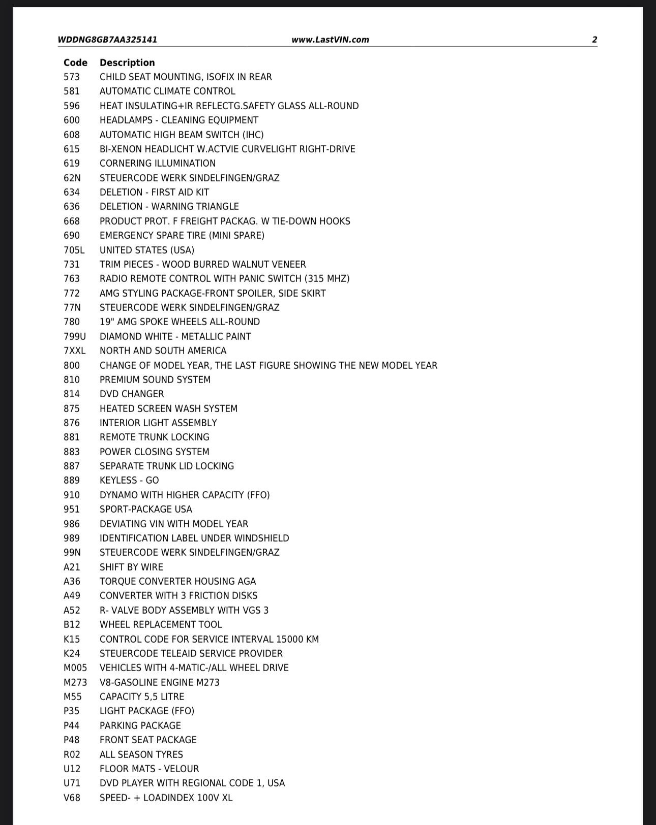

Congrats, that's a nice car
Mileage is low given age of the car but I would have it serviced anyway if there's no maintenance records . Yours is not an M278 , but can be upgraded anyway if you like
