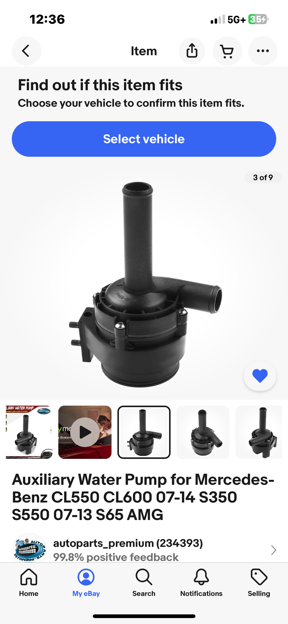

Old Dec 8, 2023 | 12:38 PM
clb0099's Avatar
Joined: Jun 2012
Posts: 893
Likes: 242
From: New Jersey
‘16 Mercedes GLE450 amg,’15 Mercedes gla, coupe,’07 Mercedes w221,’12 Audi A
Old Dec 8, 2023 | 12:58 PM
vettebk's Avatar
Joined: Dec 2018
Posts: 853
Likes: 499
From: Washington, DC
2007 S600, 2007 Chrysler 300 SRT8, 2000 C5 Corvette, 2017 Mustang GT, 2023 300C, and a 2019 Lincoln
I wonder if this is the same pump or a different design with higher capacity? I am also always concerned about ebay. Totally your call but new for $147 with a lifetime warranty vs. $71 for a used ebay part is a toss up......
