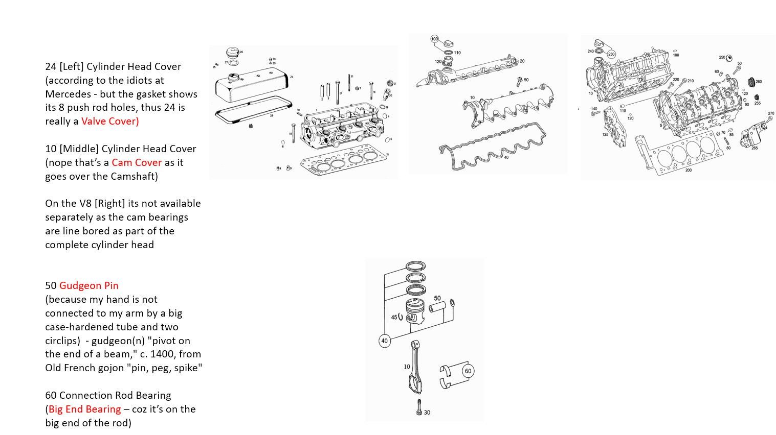

I've made you some pictures to help with your English lessons - the name directly next to the part number is Mercedes Benz's version of events, the Red Font is English
Reply 0
Jul 24, 2025 | 11:22 AM
  #37
And as BOTUS notes, these pix are a V8 not the 275 V12TT found in the S600. English is the same, but four more cylinders (LOL).
