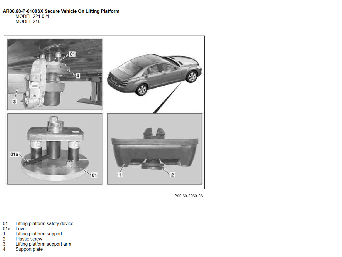

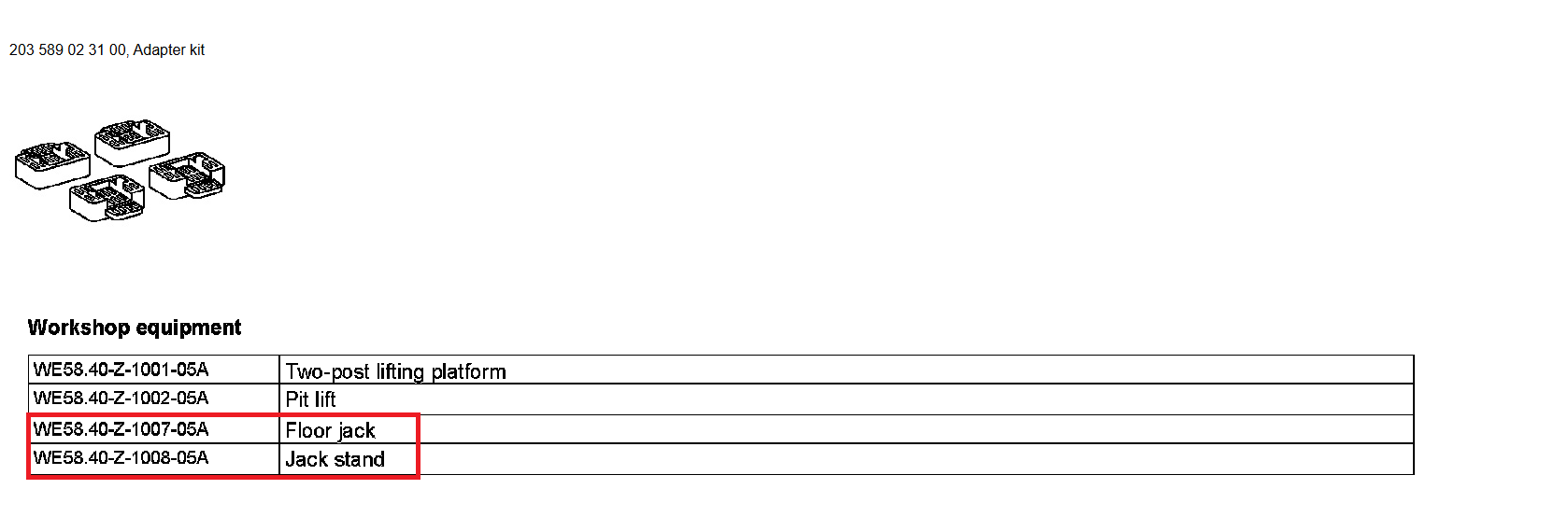

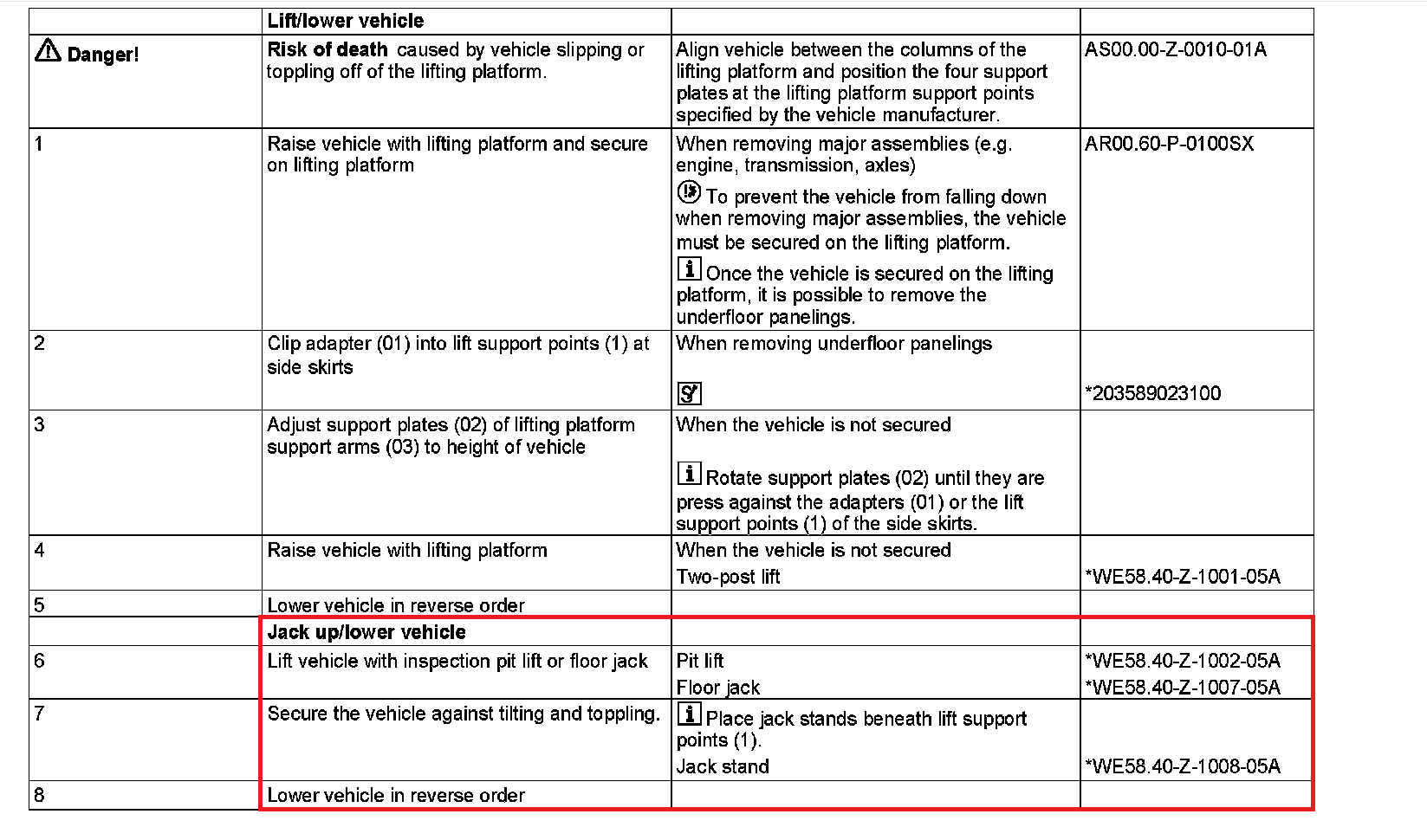

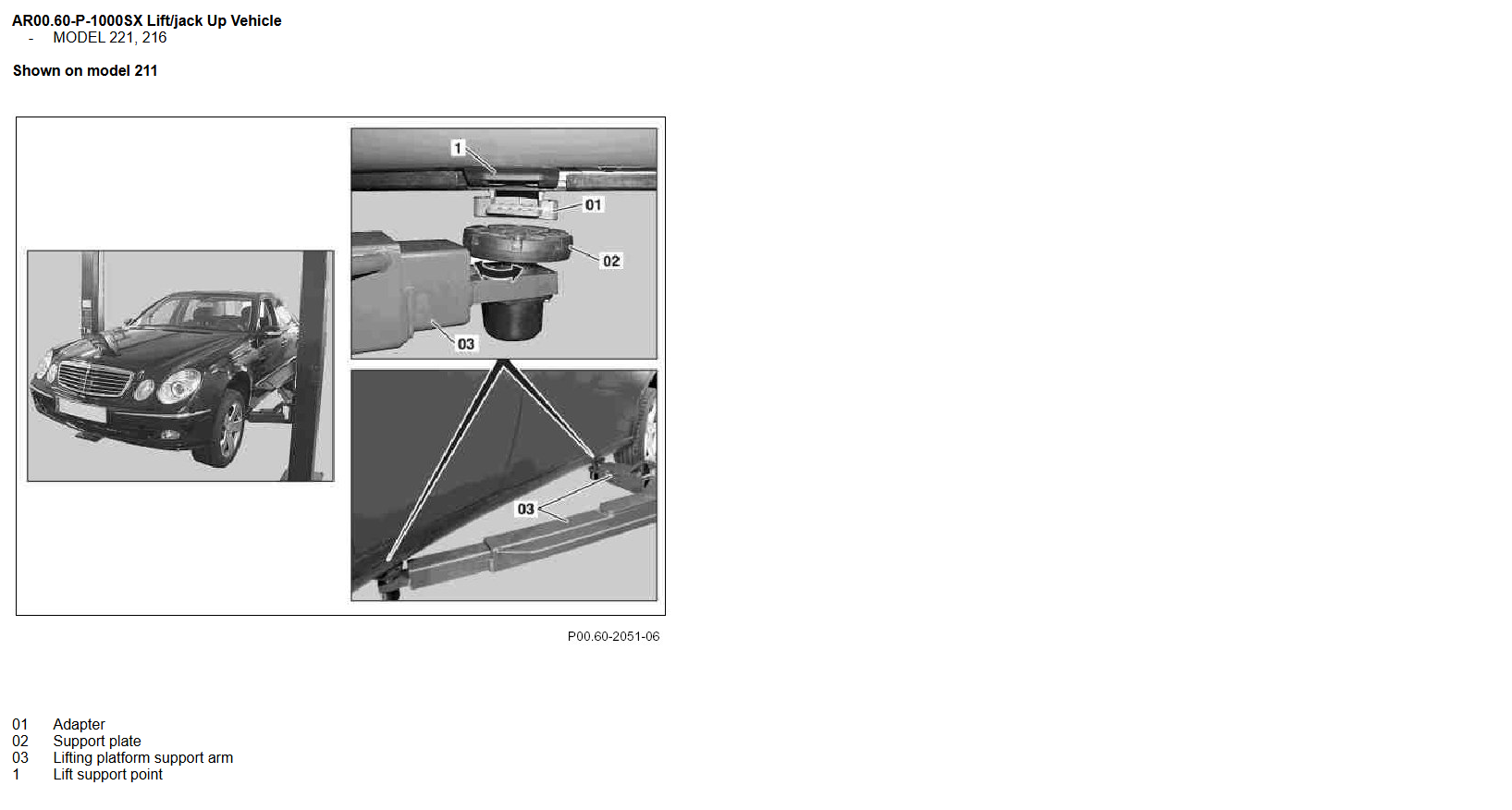

The car is designed to be lifted from the lifting points.
What are you working on that the rear needs to be raised? When I replaced the rear passenger brake line I had to remove both wheels. I did not have to go under the car but was reaching inside the wheel well and had my hands reaching across. I used a floor jack on each jacking point and raised it that way. I put blocks of wood underneath each jack arm so they couldnt lower.
The manual mentions a floor jack and jack stands but I cant find any info on what they actually look like.

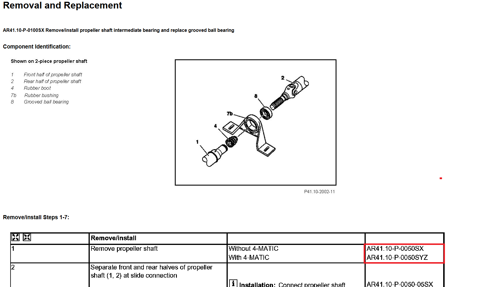

I was looking thru the manual for replacing the center bearing and dont see a reason why the wheels have to be off when doing it. Or why the wheels have to be hanging off the ground. I could be wrong.
I noticed the exhaust has to come off. When I worked on my exhaust under the car I drove the entire car up on wooden ramps I made. Made them out of wood planks, 2x12's or whatever width they are. When I serviced the transmission I had the car on my ramps. My parking area is not level so I did jack up the front a little more to level it out. It was easier jacking from the front middle jacking point but if it was the rear id jack up each side and stick another board under the wheels. Work with what I have.
Make some ramps and drive the car up. Or jack up each side and put the ramps under the wheels and lower. If im driving the entire car up I can only fit ramps 2 planks high under, if i need the car up higher I jack up the car at the jack points and stick another board under the wheels.

You could do this job on a four post lift, with the wheels on. Or like you did. My 50 yo back says no to that though.
The point to raise the car by the rear is to gain access and arc enough to swing loose the giubo bolts, as well as remove at least the back half of the exhaust.
But there is really no suitable jacking point behind the rear axle. Might just have to back it up on some big ramps, or jack each side up and put successively more lumber under each rear wheel (with a chocked front wheel of course).

only safe place to jack a 221 is the 4 sill jacking points - anything else is destroying the car
