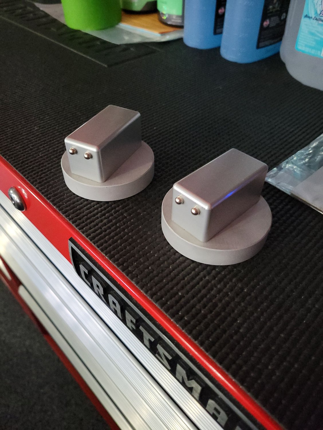

Do yourself a favor and get some of these. I had mine made at a machine shop and costed me a pretty penny but Amazon sells similar for cheap.

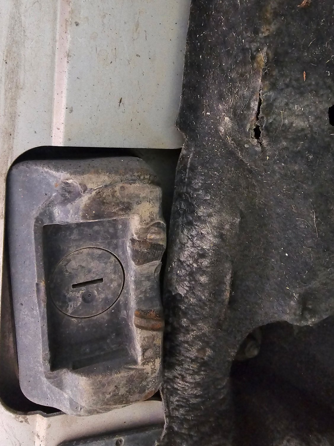

Those look great! Where do you place your jack under the car to raise the front/back? Assume you put those pieces on top of a flat pad jack stand?
Saw this just past the plastic cover under the front of the car.... sure looks like a jacking point!

Yes that is the correct jacking point for the front. As far as the rear, there is none from the factory so you will have to use the differential unfortunately. The ones I posted, go on your side jacking points but I would definitely swap yours for new ones. Those look shot. New ones are about $16 each from the dealer.
