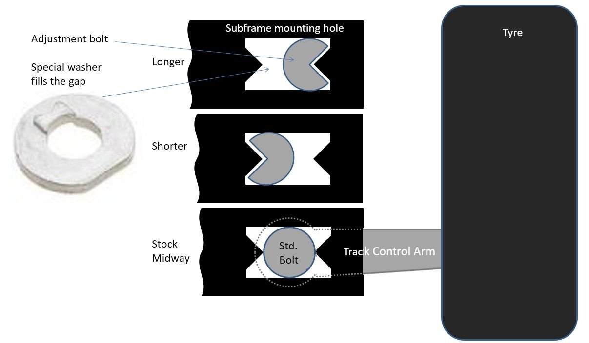

I think its part 35 that's the cause - made of chocolate and falls to bits around the correct mileage - and so rarely thought about no one looks
ABC def has a different lower arm - bush in 120 falls to bits - the strut fails to connect to part 70 due to a ridiculous design of almost zero connection (just luck)
change to special washers on part 100 to adjust geometry on the camber (right side is wrong on LHD and RHD cars at the factory because the build is a sick joke....) - only fools use the silly weak bolts - as it's made wrong at the factory and needs a one off correction grind the crap off the subframe like the expert dealership's do it - note tracking will be miles out after applying camber fix and must be corrected
202 333 03 76 or 221 333 01 77 Washer for adjustment work only (you need two per bolt)
Thanks Botus, I’ll discuss this modification with the shop next week after scheduling in the lower control arm replacement.
