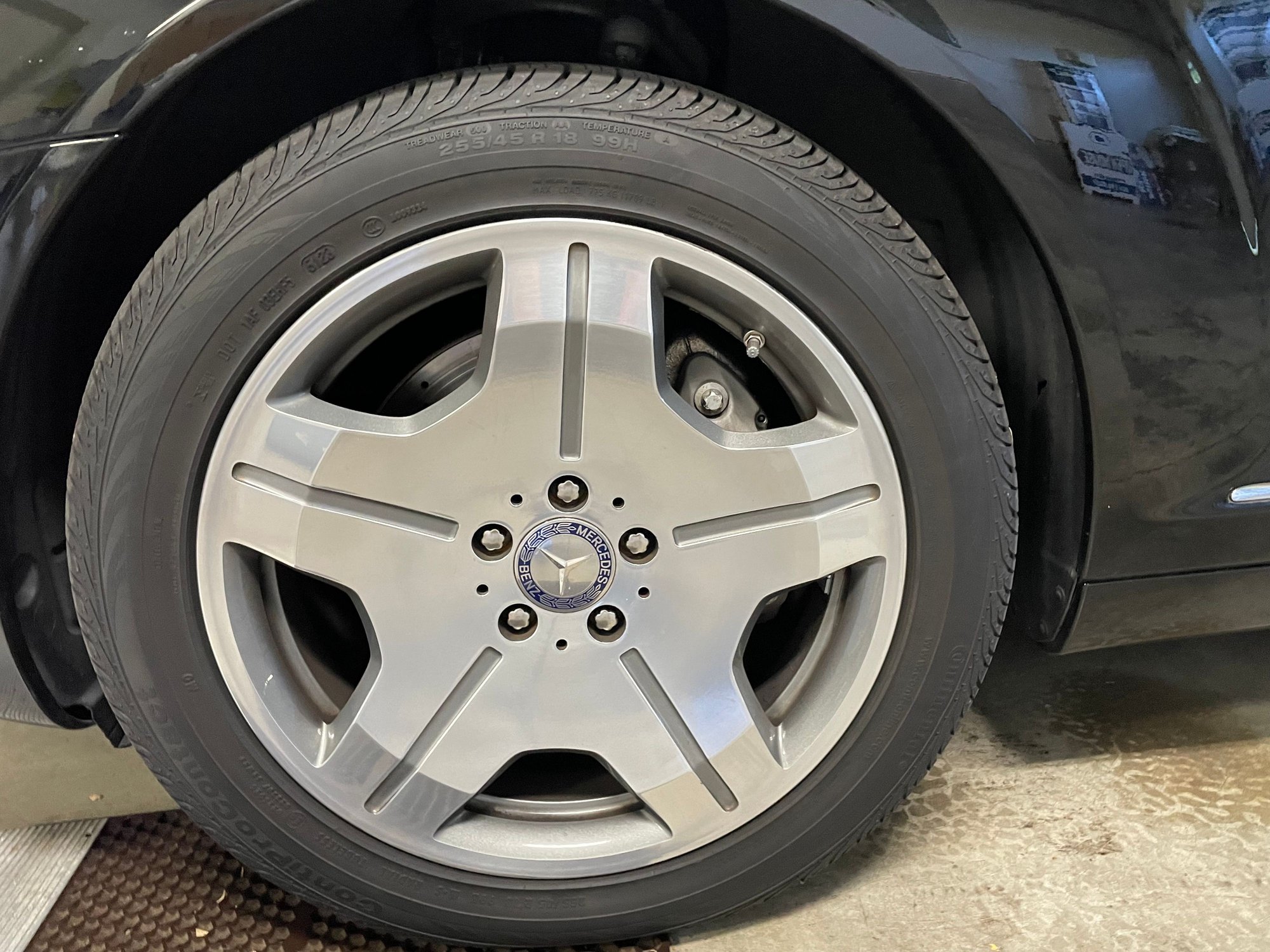

Hi Arrie, I remember you posted about the importance of centering the rim to rule out the source of the vibration. My rims I believe are MB.
These are the rims which arrived on the car.
These are the rims which arrived on the car. I’ve seen other cars on the internet with them as well.
I found again in the forum this vibration turned on for many folks at about 90,000 mile.
I’ll know more Monday as I’m taking it in to have the
torque strut bushings replaced.
I’ll update next week week.
JR

it didn't help some are responding on the brake thread you ran this week - yes those are rare Merc OEM rims
check out the bit about the inner ball joints on the steering rack I posted there

Hmm did the OP follow John Lane's advice to dismount the tires and run the bare wheels on the balance machine to check for vertical and lateral runout ? He did say the wheels were "refurbished"..So rather than starting with suspension parts, I would start by doing what John Lane said. Double check for the wheels being hub centric too as well as the mating surfaces being 100% flat. . Just because they are a rare MB OEM doesnt mean they are in good form and hubcentric with great mating surfaces. if they dont mount up properly they wont balance correctly.
Do it right or burn money and still be disatisfied.........

Thanks for the cautions about verifying the simple and cheaper first. I’ve had the rims, new tires balancing and runout verified numerous times at different tire shops.
The last shop was “The Wheel Doctor”. He used to be a real medical doctor, but he found there is more money to be made in wheels!
The verdict is the tires are balanced and hub-centric on the spindle and holes. Doctor Wheel even cleaned the spindle and rims with a wire brush. No change in symptoms.
Tomorrow getting the torque strut bushings swapped out with liquid filled ones from the all wheel drive S550 as suggested in the tech bulletin.
if no joy, I will focus on the upper/lower control arms.
