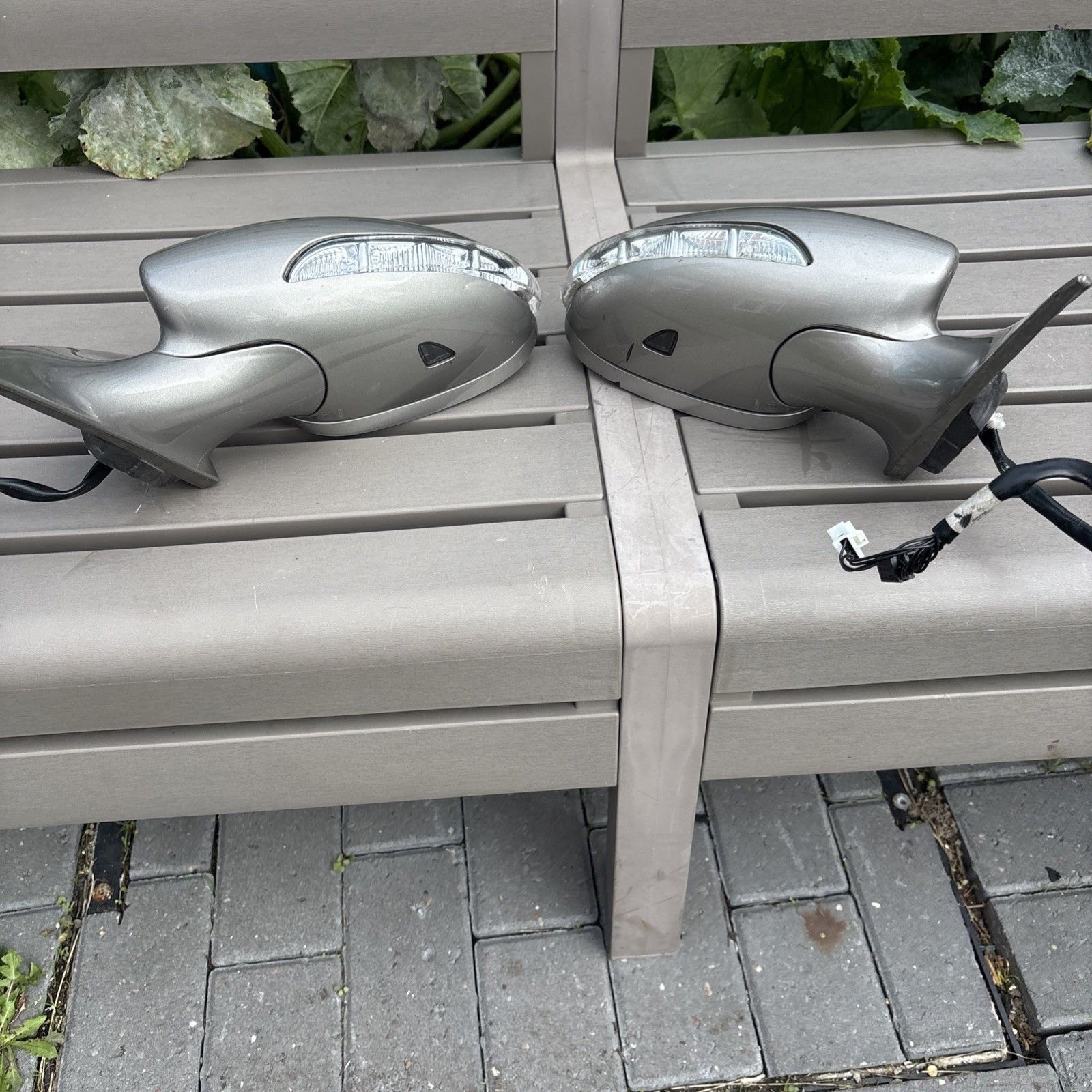

Originally Posted by Jaap
Nooo... look at the angle of the mirror housing left vs right.
Hard to find a good picture... i guess this one shows it:
Angle of the mirrors to the car is different
further to this query - those are Facelift mirrors
all my posts relate to the OEM rounded prettier mirrors used in Europe between 2005 and Aug 2009 - and the angle is identical AFAIK - why would it change....
2010 model year went with the squared off strange ones - which I do agree withe right bodykit / bumpers and later lights, does update the car to a more modern looking thing
Old Nov 17, 2025 | 04:31 AM
  #42
Jaap's Avatar
Joined: Mar 2018
Posts: 492
Likes: 182
2006 W221 S500L M273
Originally Posted by BOTUS
... and the angle is identical AFAIK - why would it change....
No no no... NO!
You can see it here, look at the length (and angle) of the mirror base:

well yes - somehow yours are different... will have to study mine when back but when I wash it there is not substantial different length of the stem on my UK car
- I actually never did the mirror swap - I bought a German one and un-threaded the two wires coz I'm pedantic and wanted OEM wiring - but would be easier to pull though wires and crimp on new pins
- never saw a difference in mirror housing and sat beside both for hrs doing the wires - it must be some USA madness - from 45 years back when I worked on cars all the USA vehicles we saw did mirrors wrong with loads of unnecessary complexity that gave a pathetic image that was no use to a normal driver - I remember one new Jag had all this **** written on the glass to highlight the cars weren't a real size Doh !!!
Old Nov 17, 2025 | 07:03 AM
  #44
Jaap's Avatar
Joined: Mar 2018
Posts: 492
Likes: 182
Well there's your problem. You have a RHD car right?
I'm sure both left and right mirrors are the same in europe.....
Dude i gave you all the evidence possible.
What does it take to convince you?
Old Nov 18, 2025 | 01:35 AM
  #47
BOTUS's Avatar
Joined: Aug 2014
Posts: 5,317
Likes: 1,673
S500
it appears you are talking at crossed purposes to where I'm coming from - you are USA market ? all along I said USA do mirrors strange and always have, due to some weird beard legislation certain states mandate
most European spec cars do them the same like they should be - both mine are identical - I can sit in the left and set both mirrors to work just as they do if I sit in the right
its not unheard of for Merc to mess the world up for all markets - go back to the w124 e class and yes those halfwits invented insane odd shaped height and length - and it was awful swap the joke passenger one for a real one and see twice as much
and on my fathers early w211 the mirrors (same housing but worse due to USA large image madness) are mounted against the car and you can't see anything... later they added the needed gap with some freaky looking things in a facelift
