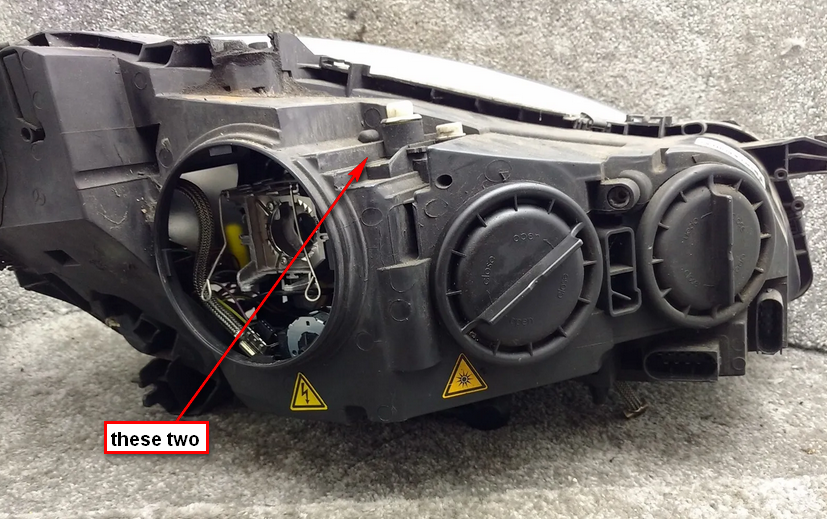

I was wrong I have no clue of what it is

that looks like an external headlight beam adjusting screw
they should sit two per side visible with the bonnet open - on the top of the headlamps unit (left right and up down)
