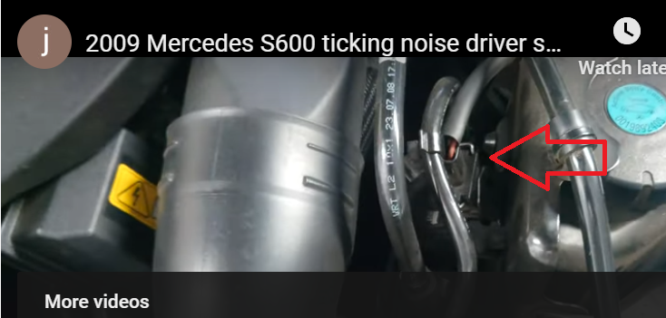

I can also hear an obvious ticking sound. See video 2. I only recorded 10 seconds of this ticking sound, but it actually ticks faster sometimes on its own, with no change in RPM. The front of the car is lifted and put on jack stands and no loads on the front suspension, with the rear still on the ground.
https://youtu.be/14TGsv-r7nQ
https://youtu.be/FOa90KYMQW0

I've got a CL550, but have the same two sounds. I think they are normal. The ticking sound I think from hunting around is coming from the ABC pump.

Ticking sound seems a lot like a canister purge solenoid. My 221 S-65 did it. Didn’t ever hear it in the car or with hood open so never cared enough to chase after it.
Nitrogen bomb doesn’t hurt anything when it lets it’s nitrogen out so you could let it go.... I prefer to be more proactive.

Yeah, ticking sounds like a solenoid issue. In fact, in that area is the purge valve solenoid which clicks about that dang fast.
Anyways, here it is...
Has a weird spring harness clamp on it so...just be careful if you want to unplug to verify. And it will set off a code. Trust me. lol. So have a way to reset if needed.

The purge solenoid clicking is it doing its job.
