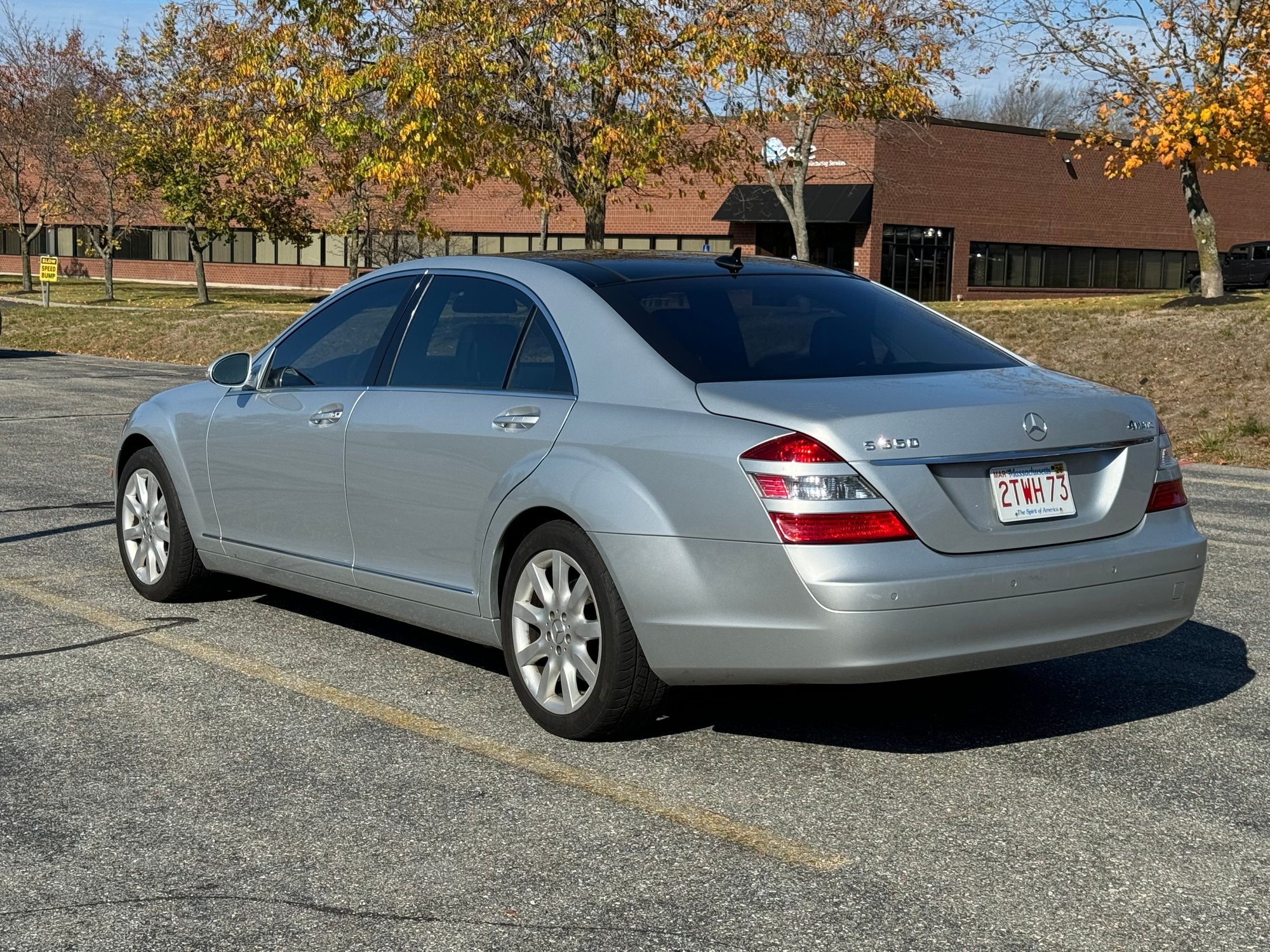

I run regular 87 octane and I have never got knocking from the engine. Supposedly knocking would be the sign of pre-detonation (aka damage) to the engine. In the absence of that, I ask what is being damage in my 273 engine, I say nothing. Why spend an extra $20 per tankful for premium. These cars have computers and are designed well to accommodate the conditions they are under. I reiterate that my acceleration is powerful and smooth and my miles per gallon is low to mid 20's.

87 is a terrible choice unless you live and mostly drive above 5900 ft
if you live around sea level like most people on the planet - you should be on 91 AKI (read the fuel cap) and running 87 in these condition you will have damaged the engine - it might be slight (it may well be a lot worse), humans can't hear the damage of slight knock - that's why when technology allowed we fitted electronic sensors to do the job
if you run rubbish (87 AKI) at sea level the engine management drops into an emergency state of tune - to try and reduce the damage
Elevation of Tewksbury, MA, USA
Location: United States > Massachusetts > Middlesex County >
Longitude: -71.234224
Latitude: 42.6106478
Elevation: 37m / 121feet
Barometric Pressure: 101KPa
