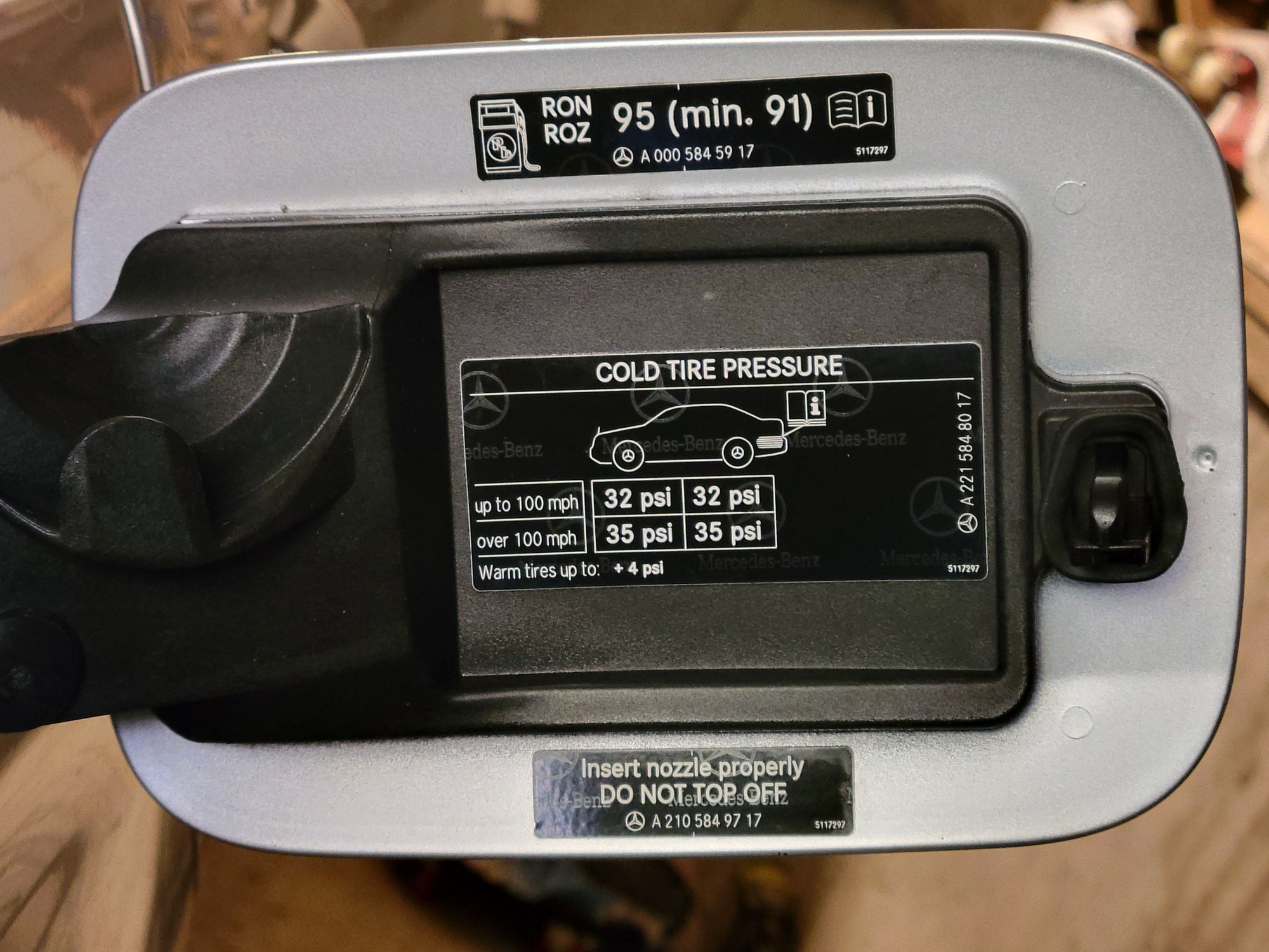

Here is the label inside the filler cap door on my 07 S550. I believe this translates to 91 US octane preferred but minimum 87, which is pretty typical of a luxury brand engine and has been for a long time.
US uses (RON+MON)/2 method for pump octane label (otherwise known as an average value). It says so right on the pumps.

so you get a Europe fuel grade sticker on a USA car - that's super helpful
two USA owners manuals put the correct data in there
2006 owners manual - page 490
Only use premium unleaded gasoline with a
minimum Posted Octane Rating of 91
(average of
96 RON/86 MON).
2010 owners manual - Page 403
a minimum Posted Octane Rating of 91
(average of 96 RON/86 MON).
