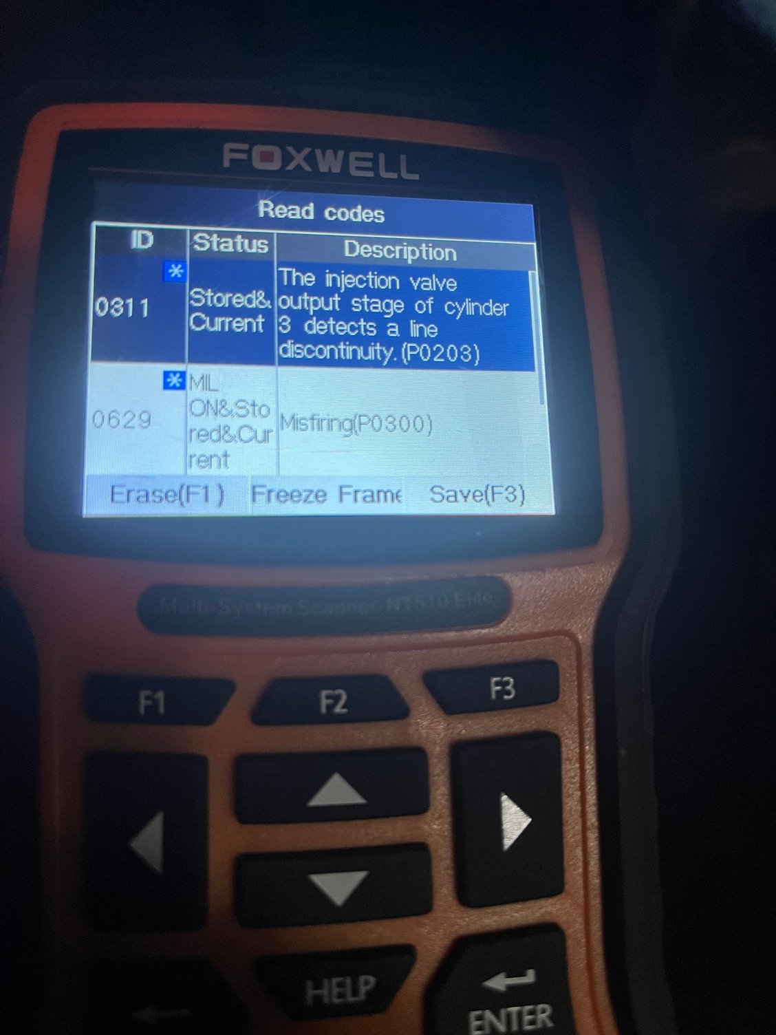

Good morning all,
I have a 2007 Mercedes s550 and recently had the intake manifold replaced by my mechanic and now I am getting a misfiring on cylinder 3. I just replaced the spark plug and coil on that cylinder and unfortunately that didn’t fix it. The car has 194k miles and is well taken care of. The fuel injectors are orginal from my understanding. Below is the obd code I am getting. Anyone else experience this? Is it a dead fuel injector or is there a possibility my mechanic might have forgot to plug in the fuel injector? Also if the fuel injector is faulty how hard is it to replace?

your title and the picture are not on the same faults
P0303 is called “Cylinder 3 Misfire Detected”
swap the coil stick to the other bank and see if the code moves
the coil sticks on these are a sick joke

it’s not the coil or spark .. I replaced both with brand new ones.

oh - I even had my glasses on
P0203 is a fuel injection issue
P0629 high signal level detected in fuel pump control circuit “A”

The problem is that is the fuel injector or is the connection? Getting to the injectors is a huge pain in the ***

could be either - bad connection or a faulty injector....
the other one might be worth going after first ?

Mechanic verified that the injector is connected… now what? Only thing it could be is the injector?

measure voltage / signals at plug when running against another
swap injector
don't forget these cars should never run with a misfire Merc CATs are the worlds worst and block for fun

Below is my mechanic showing me that power stops going to the injectors on cylinders 3&4…
