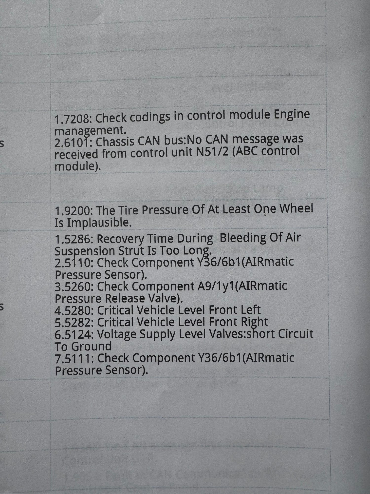

Greetings All!
Just replaced compressor and block after rear end suddenly dropped to the deck. No warnings or issues at all up until this happened while driving.
After replacing the pump (which was original) and valve block I paid a local mobile mechanic to come and reset the system. I have the attached diagnostic report and am hoping experience found here will lead me to the remaining issue.
Im well experienced with air suspension having had six Range Rovers but currently without garage space to work on a car. In that respect im limited but with tools and some practical knowledge to get by on.
What puzzles me most and the reason Im not spraying soapy water everywhere (yet) is the 5286 code “…bleeding takes too long” which doesn’t seem like an air pressure loss but a depressurization issue. Also have codes for pressure sensor 5110 5111 and pressure release 5260.
Disregard FL and FR codes as report was prior to airing them up. The are now inflated and locked holding air.
Please take a look and tell me best guess what I should be looking at.
Thanks much. Cheers!

can't have air-tragic and ABC on one car.... which make me wonder about the quality of the diagnostics
https://mbworld.org/forums/s-class-w...ml#post9095086

OP in your first post you have ABC and Air tragic codes.... was this car an ABC car backwards downgraded due to ABC costs....
check VIN decoder to see what was originally https://www.lastvin.com/
477 TIRE PRESSURE LOSS WARNER
487 ABC SUSPENSION (ACTIVE BODY CONTROL)
or buy a decent diagnostic tool that’s not lying
@Billydv1 any work on air tragic must always start with checking the level sensors move freely on the silly seize up ball joints of the link rods... two at the front and a bend and snap off impossible to reach one above the park brake module at the back

After all it was the level sensor. It is welded to the rear axle or supposed to be. This weld failed and set in motion code after code. The sensor was still functional after I reattached to the axle. System aired up and hasn't had a problem since.

they clip on to the anti-roll bar - and snap off regularly - just as they can at the front
all three are a maint item - replace every 5 years - lube plastic seize up ball joints at least once a year
