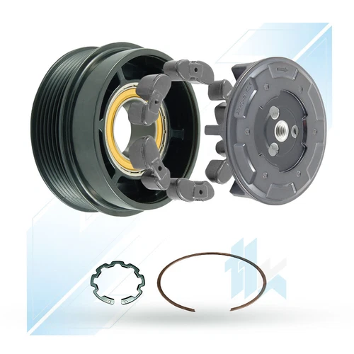

Thanks JohnLane for the info. I spoke with my mechanic again today and he said he can get just the front part of the compressor (the wheel/pulley) from Mercedes for a lot cheaper than a new compressor and thinks that way the whole thing doesn't need to come out. Apparently there is a pry tool you can buy reasonably cheaply to pry the compressor belt pulley from the compressor housing. We'll see how it goes. Hopefully, it works as it will be a lot cheaper fix than whole thing out option.

nope the thing unscrews.... remove the large cir-clip around the outer diameter of the AC pulley - leave the belt on then "do it up" via the 7mm headed nut on the end of the compressor shaft - that really undoes it and the belt acts as a great way to hold things still
pic is not the correct part just for example https://en.euro-klima.pl/EN/ek2382-c...5sl-se-12.html
the blue bit is dust seal of the deliberately undersized chocolate bearing Mercedes choose to use - you can buy the silly size bearing - but the phenolic plastic pulley will self destruct trying to remove / refit - Audi for the same type of fitment use a bearing 2 mm wider
it is also NOT a clutch - this "cush-drive" has no means to decouple the drive - which is what a clutch does when engaged

It was more about access and the mechanic's time to do it. We replaced the bits in the attached picture (genuine OEM versions) and a couple of belts and 1KG of aircon gas, but it was still £750 parts and labour. We'll see if the compressor lasts

if he only swapped the pulley and re-gassed its way less than 60 mins work and $150 in parts and labour
many seem to be using incorrect terminology - there's been no clutch on pretty much any car AC compressor for 20 years
what you have to absorb noise and vibration is a cush drive. This is a feature that is designed to reduce stress on drivetrain components during use. A common design typically consists of rubber blocks that damp the transfer of force between components and effectively reduces shock loading, cutting noise, vibration, wear and fatigue of the components.
the old world noisy clutches were to (electromagnetically) switch on or off the drive to a fixed rate compressor - for more than twenty years they switched over to a variable rate always on compressor - that uses a swash plate - this is usually linked to the engine management and improves emissions, economy, idle stability, and for low power application winds back the AC compressor under heavy loads (acceleration or hills etc.)
