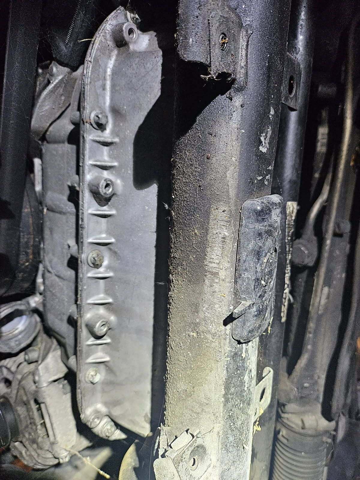

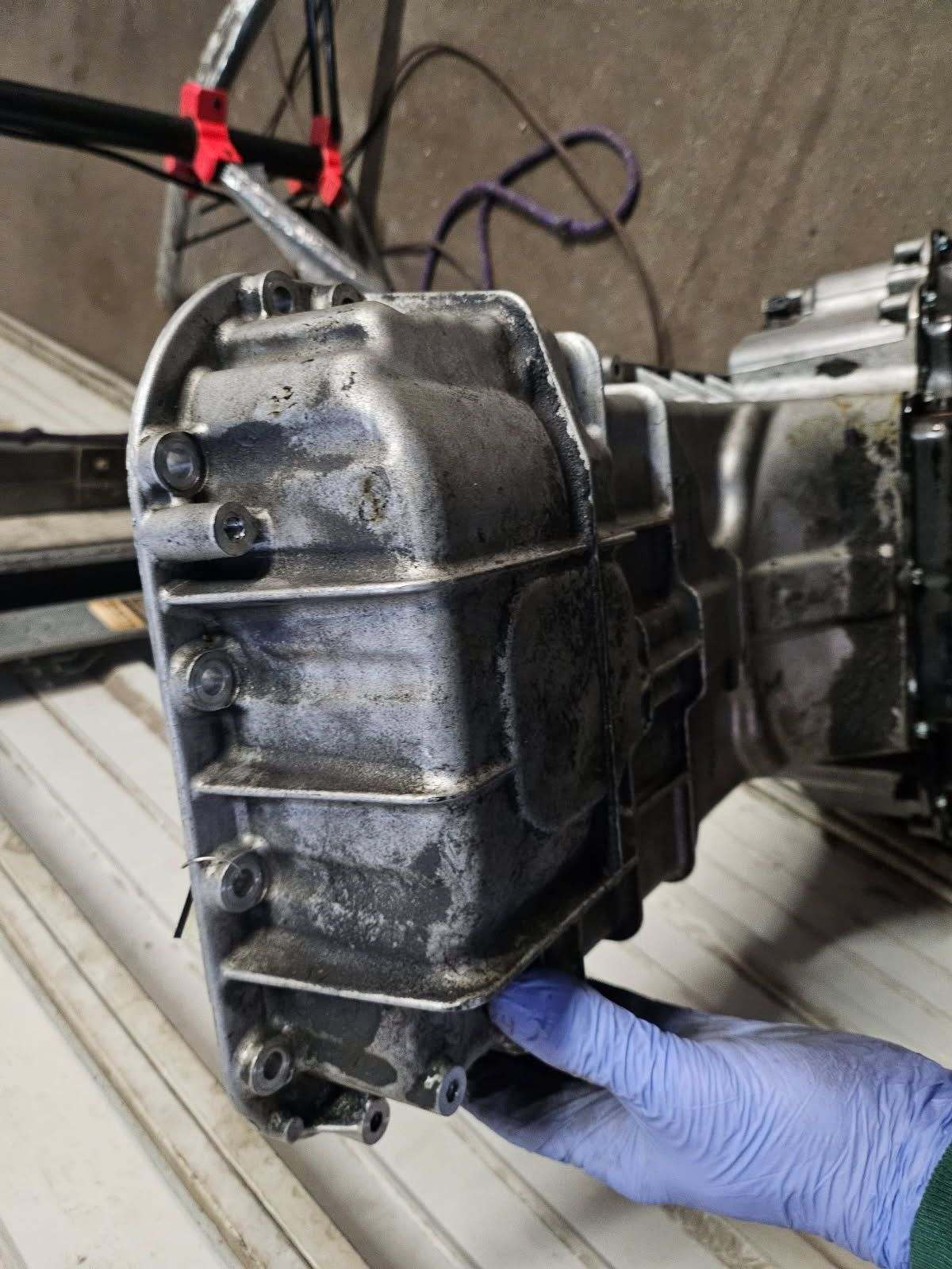

Good afternoon y’all, this is a question for those that did the m273 engine swap on the w204, so we ran into a little problem about the oil pan, since my friend that I bought the project from got the s550 engine, I was told to get the e class oil pan and I’ll be fine, well the e class oil pan has 4 bolts but the s class has 3, now it probably won’t fit. I know of somebody that also used the s class engine but lost contact with him so I am hoping there is still somebody out there that knows the exact correct oil pan I can use. Your help will be very appreciated.
The first picture is the 2010 e class oil pan and the second picture is the s class oil pan, still on the s class engine (not sitting right because the sump is in the front)
