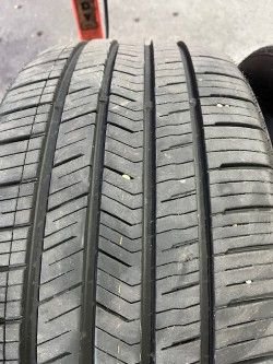

Bought Nexen Platinum N5000 tires for my car last summer. Almost fishtailed of the road driving in light rain a couple weeks ago and was wondering what the heck is wrong. It could not be the tires as they are 50000 miles thread warranty tires...right?
Turns out my rear tires completely wore out in just about 12000 miles and my driving is 85% non-abusive highway driving, see pictures of the used rear and front tires.
The rear tires have a slant with slightly more wear on the inside, which is due to the camber of the rear wheels. This is NOT a toe issue. The tires, that came out from my car before these Nexens, wore severely on the inside edge due to the toe being way too open, but those tires ran 45000 miles. When these Nexens went on I had the toe problem corrected as I did not want to wear them out like the tires before them. If I had not fixed the toe these Nexens would probably have been gone in just 6000 miles.
The front tires were about half done and probably could have gone another 12000 miles.
I cannot rotate tires front-to-read due to staggered setup, but I can side-to-side, which I did once after about 6000 miles.
Just a warning, Nexen Platinum N5000 is not the tire for the W221.

looks like camber issue helped them wear quicker on inside edge first

Yes, I believe the camber is why they wore slightly more on inside but wear was even “slant” and not a toe problem that I had with tires before. Those wore at inside edge down to fabrics of the tires while 2/3 of the outside width looked like half of the tread was still there.

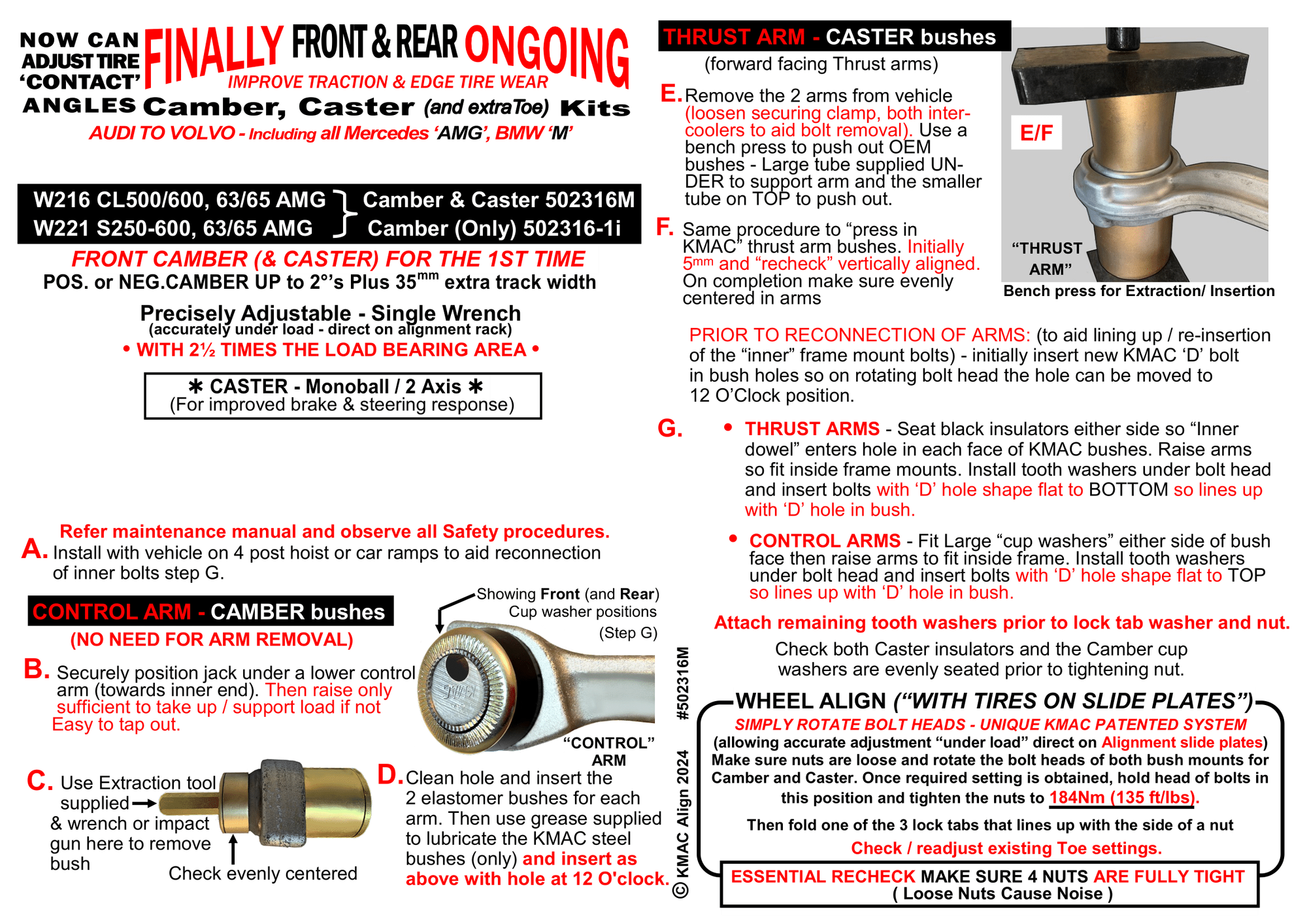

Yes today’s models essential Camber (also Caster) adjustment - to adjust tire contact angles / spread load more evenly has been deleted.
Onus now back on owners - to fund costly, premature tire purchase because of excess edge wear !
Today it is all about speed of assembly lines, cost / efficiency and therefore - now only one Camber and Caster setting - “to suit showroom height conditions”.
No more ongoing adjustment for curb knock damage or to counter excess passengers side edge tire wear through high cambered roads.
Excess “inner edge” wear / Camber change both sides - caused by altered height - load carrying / lowering or spirited driving and excess “outer edge” wear.
New car industry’s best kept secret. Still re assuringly quoting to carry out a “Full Front & Rear ‘4’ Wheel Alignment” But the reality it is now only basic Front and Rear TOE “directional” adjustment !
At K-MAC 60 years experience - resolving OEM suspension shortcomings. Including manufacturing “Bolt-On” adjustment kits - requiring “no special tools” or time consuming control arm removal to install.
Also specially designed so easily accessible to adjust. Unique Patented single wrench adjustment system - Ultimate direct on alignment rack UNDER LOAD.

Any instructions how to use these bushings on the w221?
