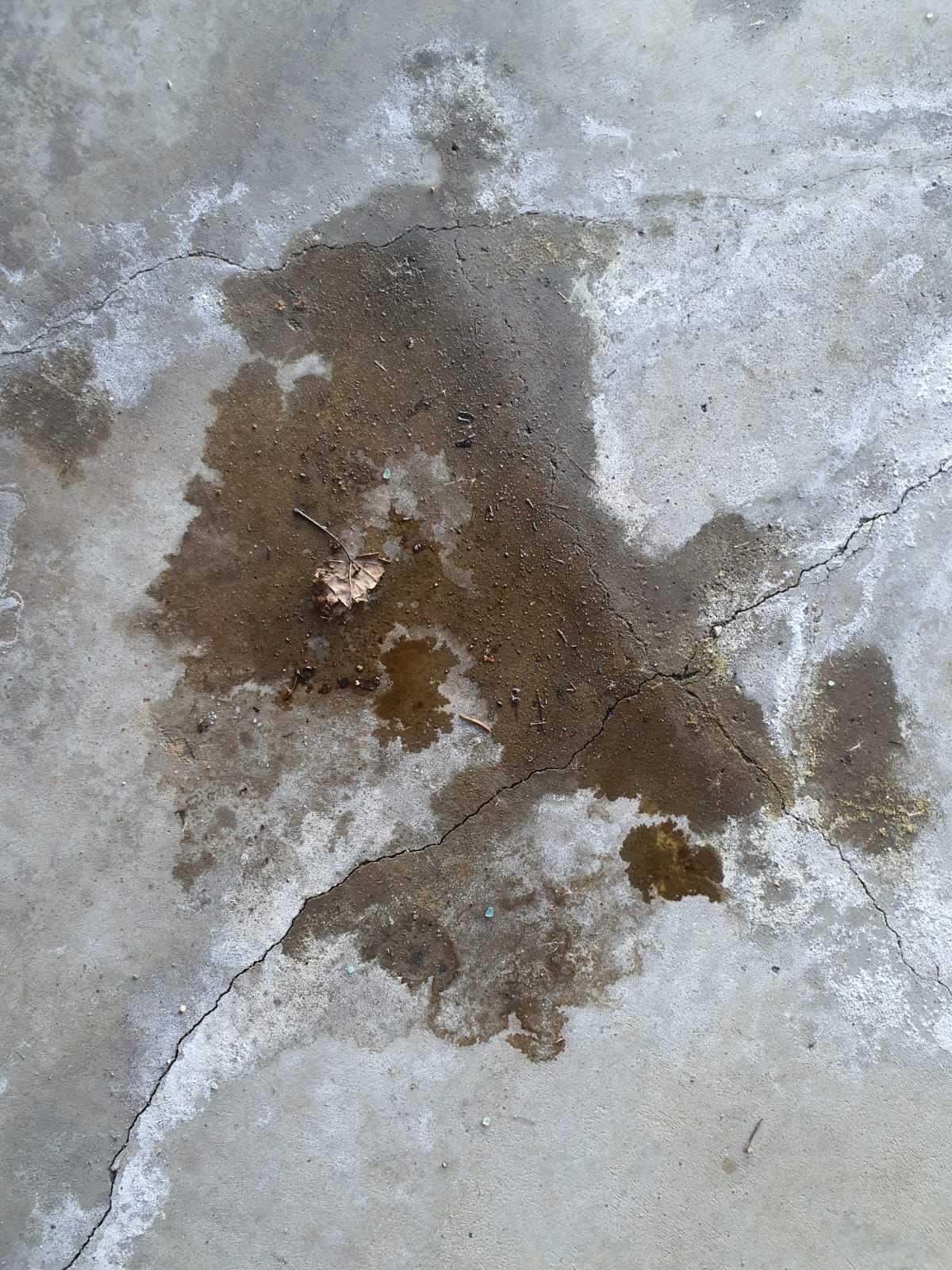

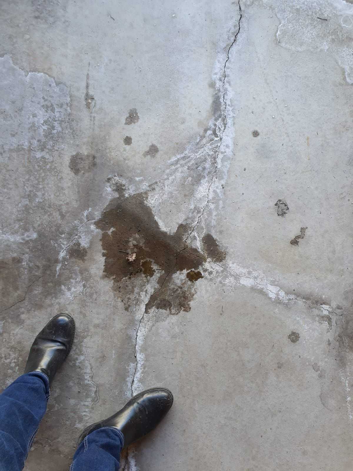

I found these drops under my car today, what could this be ?

anything
smell it, taste it, try to work out where it came from

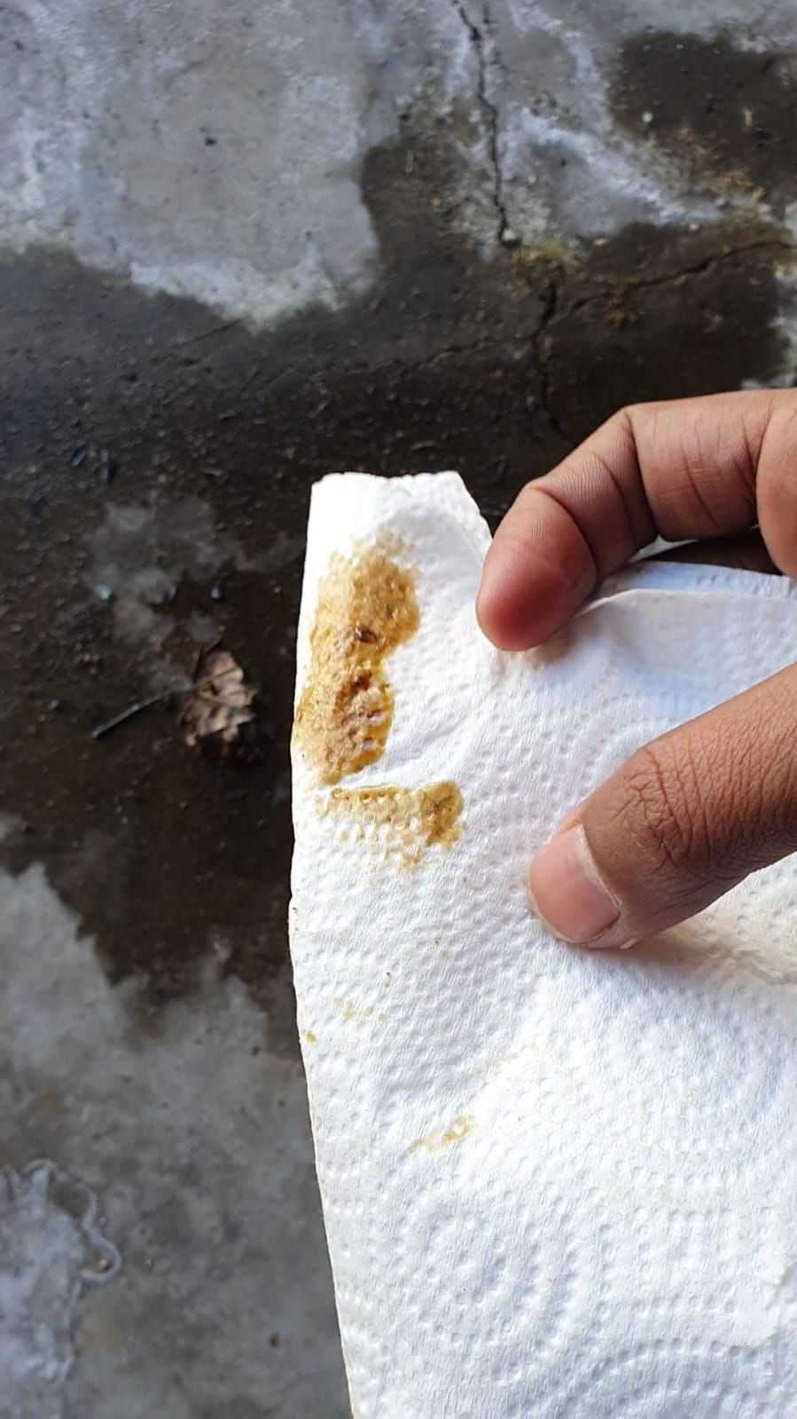

It doesnt smell anything burnt..I didnot taste though hehe ..what to expect from tasting ?

auto box, engine oil and diff oil all taste and smell very different and start life as different colours - but they get closer with age and wear - after all they are mostly just dead dinosaurs
goodness knows how to describe it in a way that works....
the stuff in a diff for extreme pressure applications is like nothing else, once you know it you know it for life
engine oil is either black from all the death tractors push out - or stinks of hydrocarbons from the fuel during cold starts and acids and junk from contamination
probably best to start with where on the car you found it - and exactly what car and spec it is - but even that’s messed up - in the old days it was easy - now engine covers down below can hold rubbish for years till enough weeps out nowhere near where it first escaped
I'd say engine oil but could be dirty auto box, or PAS or...................
you could try to match the smell on the tissue to that of the engine dipstick - the PAS reservoir, the Brake reservoir and again if they'd given you one - that of the autobox dipstick
of course check the levels whilst looking - and don't get dirt in there when checking

from the colour you see in the photo here, do you have any idea? It is not sticky and thinnish

When you got down on the floor and searched for 30 minutes with a bright LED flashlight, what did you find as the source of the drips?

Get it on a lift and bring a flashlight. You expect us to tell you where and what your car is leaking from some pics of misc fluid on the garage floor ?
