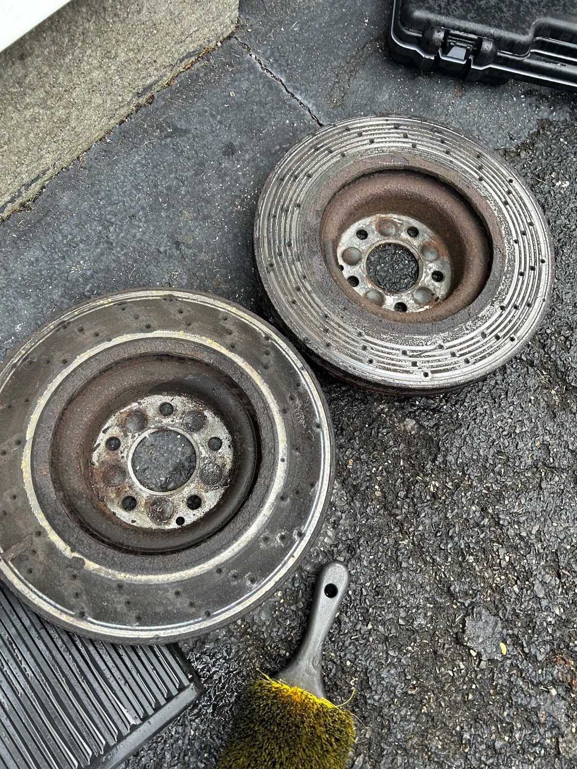

I’m coming up on four years of ownership and this car has been pretty consistent about asking 1-2000$ every summer .
This April was extra spicy. $5000 or so.
Rear struts MB
Trans oil change, filter, pan
Rear End fluid .
Front Lower control arm MB
Front forward control arm MB
All 4 Michelin Pilot sport 4
Front new rotors MB, pads, dust shields.
Alignment -MB dealer.
Before dumping more money into this car, I debated about moving onto w222 but I just couldn’t justify the expense. Bore score and new issues is last thing I wanted to think of.
I thought about getting into a Lexus Ls460 again, 2015-16, but it just didn’t excite me.
Looks like we’ll still be together for a few more years.

My 221 demanded all four front lower arms, front brake rotors & engine mounts annually. Every 20,000 miles. A/C compressor, alternator, radiator within a year.
The 222 got the pair of lateral arms in front suspension + F & R brake pads (first time!) at 90,000 miles. A water pump, all idlers and a belt tensioner at 120,000 or so. Upper control arms for noisy bushings at 130,000.
Clearly the 222 got real effort put into solving wear issues of the 221. 144,000 and the 222 is still blowing ice cold, alternator is great and no leaky radiator.
No bore scoring in the bent 12. Save your pennies for an S-65. Worth it.

Good news is, I had the alignment redone at the dealer after installing new tires . All is perfect.
but the bad news is, I need an upper control arm on one side since it’s creaking. Also yesterday noticed a clunking noise from front right. The struts are 2 years old and their ball joints are already torn. It’s fine on small bumps but heavy bumps I hear a rattle. Sounds like a strut?
Why can’t the strut ball joints up front be changed? I can’t be changing them every 2 years. That’s 2300 with labor.

The ball joints on the strut can be replaced with ABC. I'm guessing there are similar products on Airmatic.

Airmatic struts do not have ball joints. In front there is ball joint but it is part of the load bearing control arm. In rear strut has a hole at bottom just like a regular shock absorber has.
The too mounts with three screws on both.

I thought I’d update you fine gentleman on some of the new issues I’m a dealing with now.
Previous round of repairs have only granted me 3 weeks or trouble free motoring.
Today I went in to figure out why the front right was clunking over bumps. Turns out the 2 year old strut has had enough. I don’t know what brand it is but I think the shop that installed it said it’s continental which I don’t believe. While in there, we found upper and forward control arm to be a bit tired and since the strut will be coming out why not change it.
Ordered MB control arms and Bilstein front strut for this repair. About $2000 all in all.
So I am about $7000 in upkeep and repairs this year/ season/ last month. And summer is yet to arrive.
I a feel a bit detested thinking about all this, but I’m in a fight to keep things in tip top shape. I could have don’t non of those things and the car would clunk along just fine.
I am coming up on 4 years and 23k miles of ownership and if my math is correct, I’m in a $13000 range worth of repairs in the past 4 years.
Ford the record, this will be my last air suspension car. I always had air suspension cars and there is just zero benefit to them but a whole lot of added expense. My last Lexus Ls460 had regular springs and rode much better than this w221 in every regard.
They are zero cars on the used market with 4 doors, v8 NA and no air suspension. Last one was a Lexus 2016 LS460 which I wanted to get but kept putting it off. Still might go that route after this car. In retrospect, I should have shelled out 30k and enjoyed a reliable smooth classy cruiser. Would have costed the same and that Lexus would still be worth 20 k now.

Well all work has been done and I am happy for a short while till next thing goes.
at this point I feel like a mad man putting out fires with gasoline!
I did change the rotors and pads and shields myself, which gave me some satisfaction and lots of muscle pain the next day.
I feel like Akenobo pads don’t bite as hard as EBC ones I had on before. But then if you see the old rotors, 30 % of rotors was not even used. Maybe they will get better with more miles on them.
