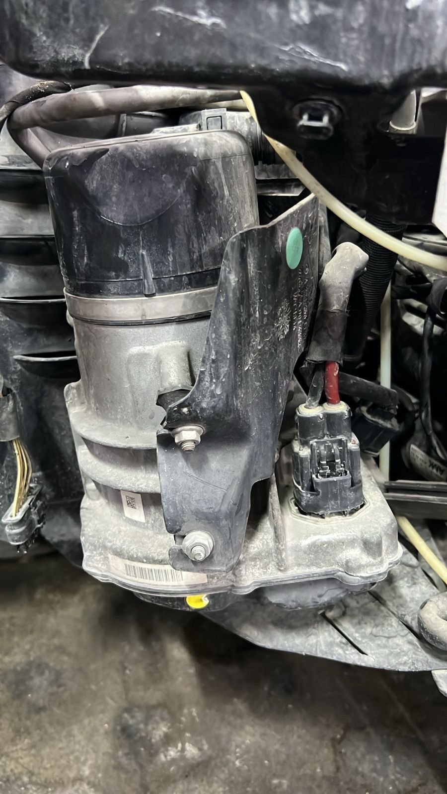

Recently on 2010 S550 W221 “POWER STEERING MALFUNCTION” flashed on the cluster for a period of 5 seconds on one instance and for another 5 seconds on another instance. Now I have been advised to replace the electric steering pump. Can anyone advise if we have to do an any kind of software update or load after replacing this unit. Your comments and advise would really be helpful.

How to check the flashware and if have to be installed where can I get the software

try benzninja - electric PAS was only on the last models - quite normal on all other brands water gets in and slowly messes them up inside - many can be rebuilt and made water tight - unlike the crims at the facotry
https://benzninja.com/
